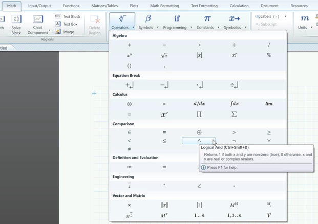

Mathcad (and even Prime) definitely HAS an "and" statement!
But of course you could nest two if statements with else to get the same effect 😉

I don't see it in my Prime 4.0. I even tried in resources but it was not there
In the meantime I attached a picture to my post above which should make it clear.

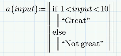

BTW, for the example you posted you don't need any "And":
