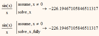

Here it misses the fact that your function is undefined for x=0. It gets even worse, if you tell Mathcad to omit x=0:
Its beyond my understanding why we get -72*pi now and why MuPad switches to float mode.

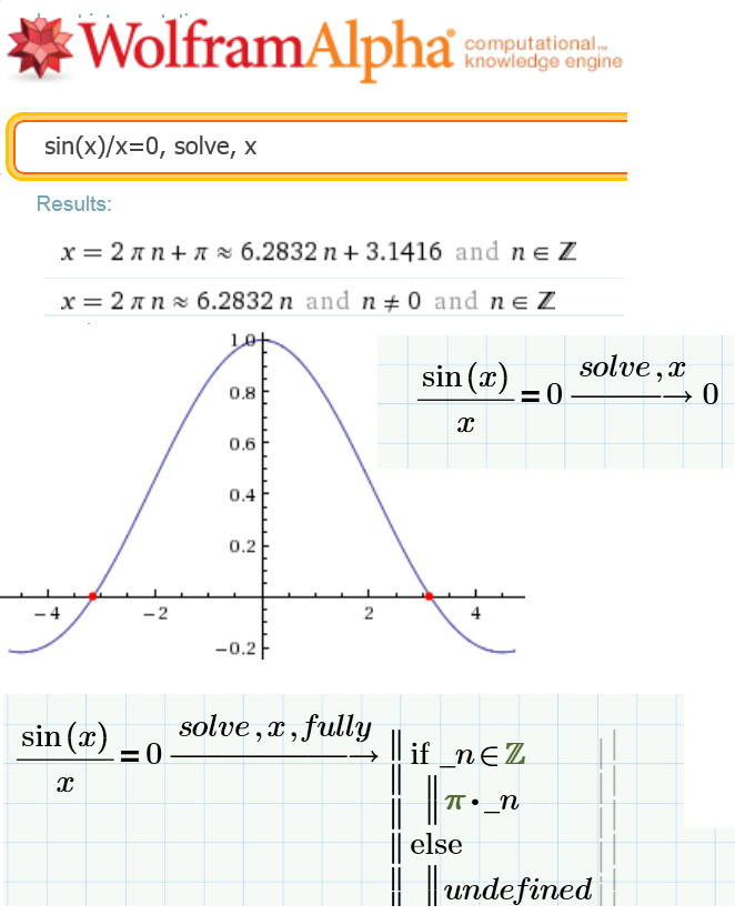

The symbolics seem sto consider the nominator only in these cases and finds a wrong "solution", similar as in the following:
BTW, WolframAlpha's result could be simplified to
so its not perfect, either, but at least the result given is correct.

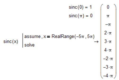

Nov 22, 2014 1:52 PM UTC
How about:
(sinc(x) is Mathcad's built in function for sin(x)/x; though, if you prefer, you could replace it with sin(x)/x in the above and would get the same results)
Alan

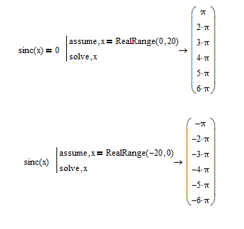

Nov 22, 2014 5:20 PM UTC
Thanks, but
Nov 23, 2014 8:54 AM UTC
Yes, that's why I gave the solution in two separate ranges.
For some reason Mathcad insists on giving x=0 as a solution if the range crosses from negative to positive. I suspect it is actually just solving sin(x) = 0.
Alan

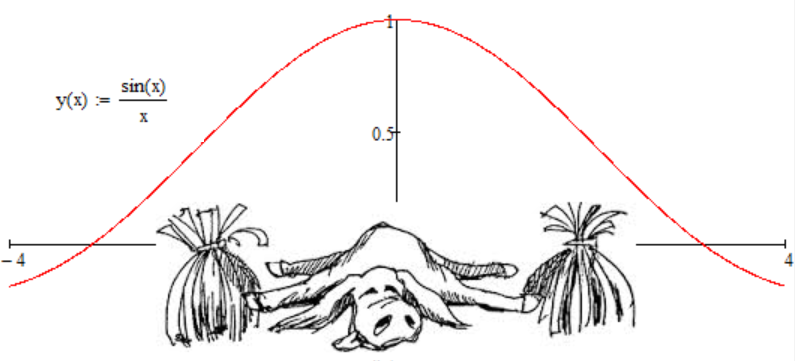

Nov 25, 2014 4:58 AM UTC
One Buridan's ass problem
https://en.wikipedia.org/wiki/Buridan%27s_ass
y(x):=sin(x)/x x:=0 root(y(x), x)= ???
I think we use the Newton method in Prime (???=error)
http://communities.ptc.com/videos/1411
and the secant method in Mathcad 15 (???=1910 pi)
http://communities.ptc.com/videos/1466
