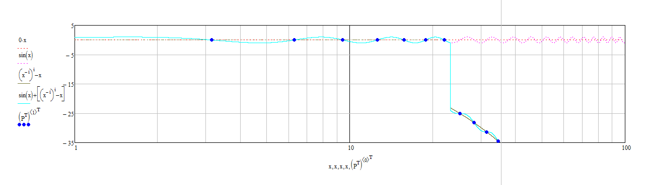

sin(x) - x + (x^-1i)^1i , solve fully ?
    Hello Everyone.
       Best Regards.
23-Emerald V
By ordinary rules sin(0)=0 and (x^-i)^i=x^1=x. I guess that's why Mathcad 11 (Maple) gives this answer:

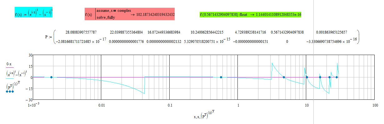

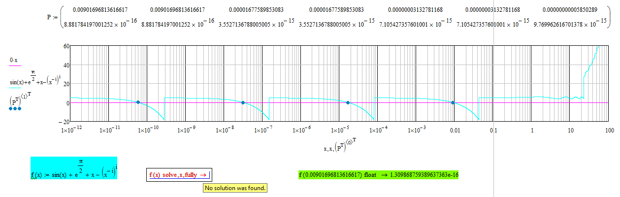

   Hello Everyone again.
       The question : sin(x)  +  e^(pi/2)  +  x  -  (x^-1i)^1i  solve, fully ?
              Best Regards.
                    Loi
lvl10720-TurquoiseAuthor
20-Turquoise
     (e^1i)^1i  -  (x^-1i)^1i  solve, fully ?
