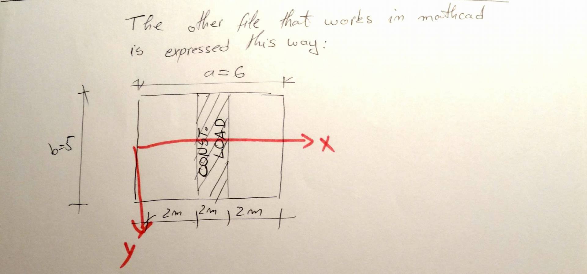

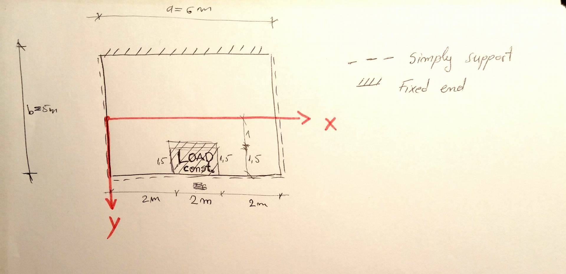

Im solving an exercise with Levy's method but in the end I'm having a discontinuity in the displacements of the plate. The problem is of this form:
The problem is that at the point y=1 i have a discontinuity and I dont even know where the problem is. . I will upload the file im working in, and also a file where i tried the load ti be continuous in y-direction, as in the following figure:
As always, i hope that any of you will be able to help me.

The function p (y) creates the discontinuities, is unavoidable.
Does this mean that this model can't describe this type of loading. Because mathematically it would be okay but physically something definitely is not right. I think there is a problem somewhere but cant find it .
