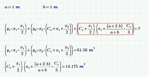

Sir i have two equations "a" and "b" are the two variables how to find the values of and b from thease equn

You could setup a solve block to solve the two equations. However, it seems you have an error in your formulas, see below.
Mike
23-Emerald V
November 23, 2015
Put the two equations in an array and choose 'solve' from the symbolics menu and supply a,b as the variables to solve for.\
I replaced the (assumed)  knowns in your equations with other constants and solved.
If you don't have a symbolics menu in Prime, you're using the Express version.
You should be able to take it from my solution.

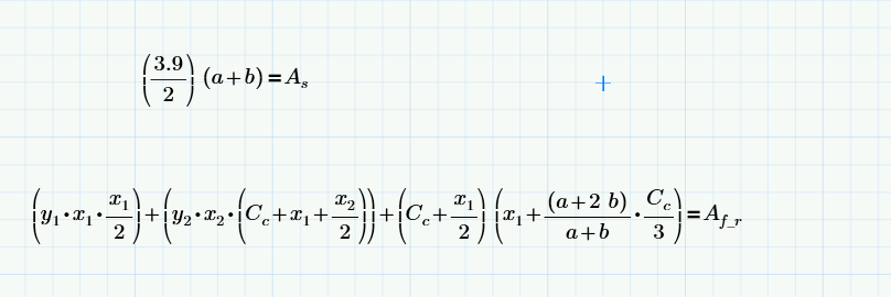

Sir check this file i wnt value of "a" and "b" from this please correct it and attach the original file
23-Emerald V
December 1, 2015
Ok, here you go.
