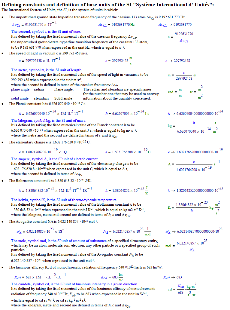

I'm sorry to tell you, but you will not do a long way if you do not learn to use the units of measurement of physical quantitiesits and  its multiples and submultiples as well .
23-Emerald V
At present the following definitions apply in the SI:
But work is underway to change the definition of base units of the SI,
which is planned for 2018, refer to http://www.bipm.org/utils/common/pdf/si-brochure-draft-2016b.pdf

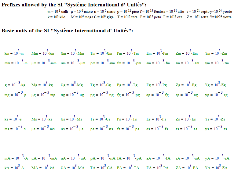

Then you can:
Why so limited to just a few prefixes?
etc.
