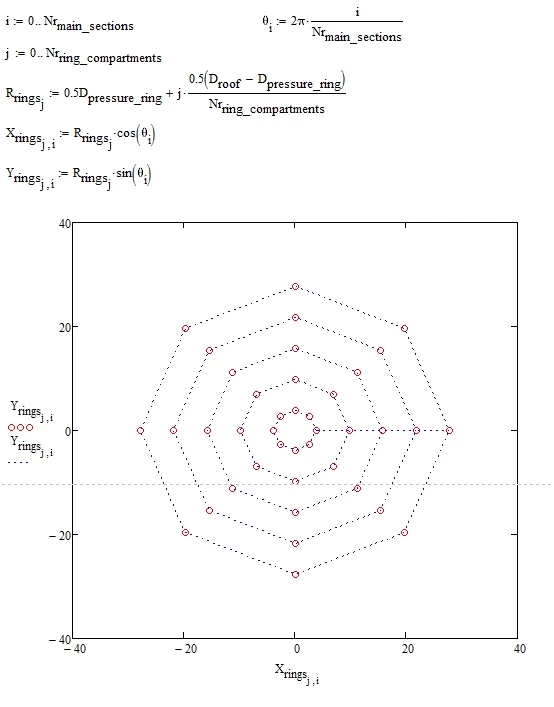

i have a question about a vector plot.
In the plot (attached as a picture), i only want to show the points and the ring segments.
At the moment, also the connecting line pieces to the next ring segment are plotted. (resulting in a straight line on the X-axis)
How to get rid of these connecting line pieces?
Tx in advance

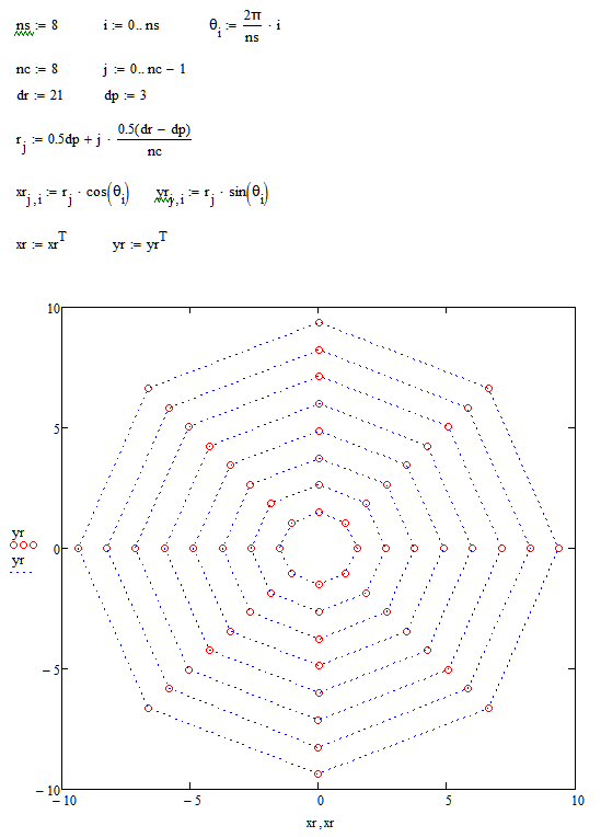

Mathcad plots by columns (your indexing effectively makes it one continuous line), so simply transpose your x and y matrices and Mathcad will suppress the joining lines.

cgeijs1-VisitorAuthor
Aug 31, 2015 6:54 AM UTC
Hey Stuart,
tx for your simple and effective solution to this problem!
