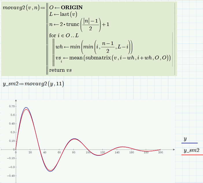

Here is a suggestion for a symmetrical moving average window
The attached file is in P3 format, so your P2 will not be able to read it - therefor the pic.
WE

Werner_E25-Diamond IAnswer
WE
