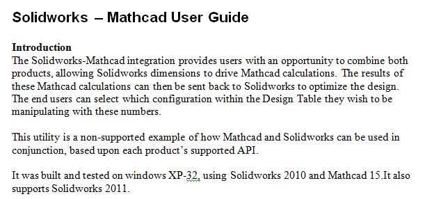

The citation from the description on integration of these products:
Jun 3, 2011 1:45 PM UTC
The current free downloaded sample of Mathcad integrating to Solidworks was developered in Mathcad 15 on XP-32 with Solidworks 2010. It was tested against Solidworks 2011 as well. This version should work with 2009, although I did not test it. The previous version supported 2008 and 2009.
Let me know if you have any troubles.
