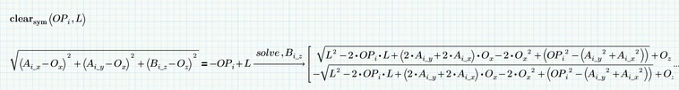

I write a new calculus sheet, with it, i want to calculate a kinematic for parallel glide structure(  is it a Clavel's Delta robot variation)
In my sheet, i don't understand why prime don't solve the last equation
see attached file
Anyone can help me ?

The reason is that OP.i is a matrix and so is the RHS of your equation!
If you clear OP.i (and L) for symbolic calcs, you get a symbolic result

Great ! ( i don't know clear function.)
It is possible to use it in program for calculate  all value for
B1_z ; B2_z ; B3_z
I need to calculate it for each leg
I don't know to make it in one program. I want this program give me B1_z ; B2_z ; B3_z for control robot
XDN14-AlexandriteAuthor
March 18, 2020
Another question:
it is possible to keep only positive root, and , it is possible to assign this solve result to a new variable ?
