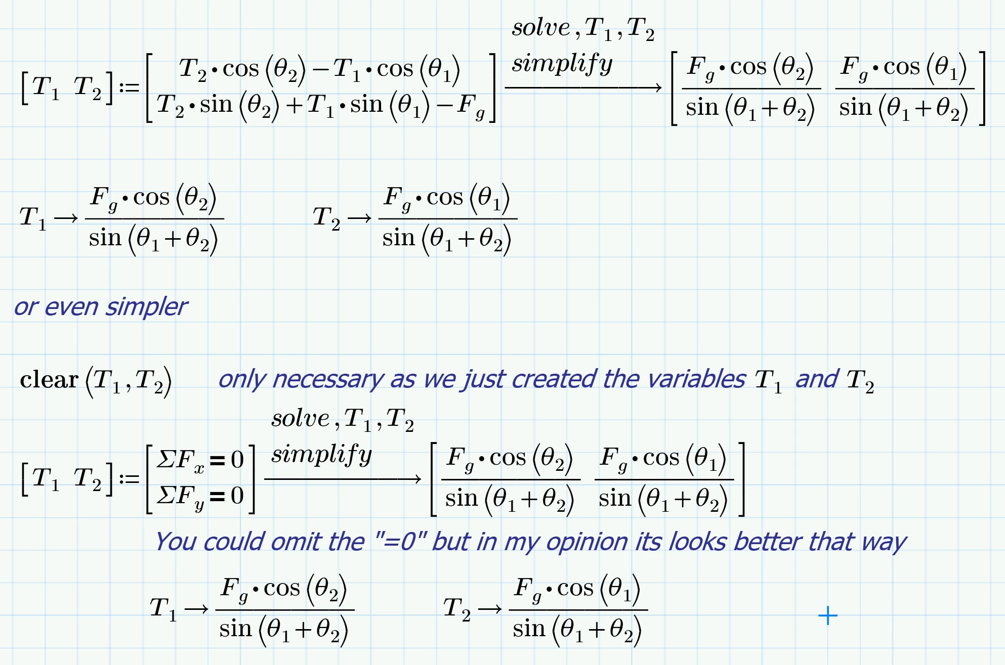

Here's an alternative solution.
Worksheet in P4 format attached

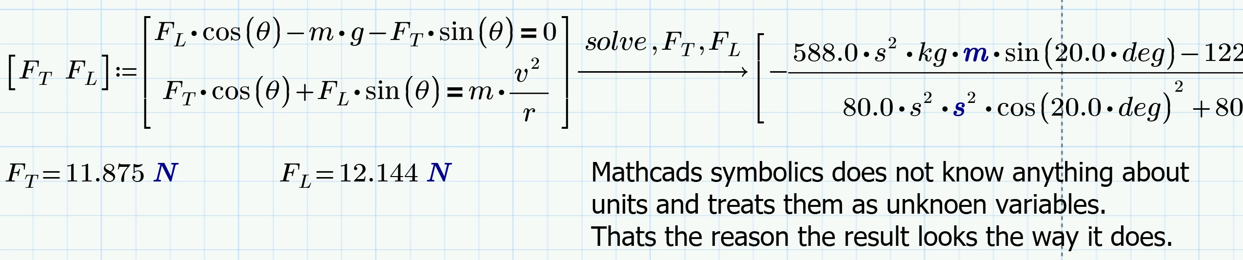

Similar to the system we solved before.
You have to solve for both unknowns.
Its sometimes necessary to set the labels for the variables by hand as Primes autolabeling very often fails.

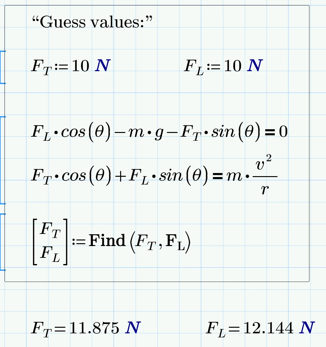

Here is a solution without using the symbolics. We can use a numeric solve block as all the other of your variables have been assigned numeric values.
This solve block was less sensible wrt the labels of the variables.
Worksheet in MP4 format attached
