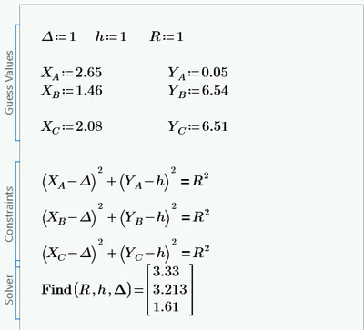

solve 3 equations with 3 unknowns
Hello everyone! I've already tried to solve in a block, it seems that something is missing, I'm waiting for your solutions, a lot of thanks

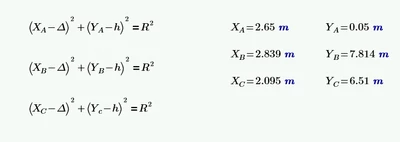

March 16, 2021

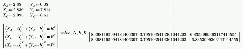

One possible and quick solution would be without units of measurement:
23-Emerald I
March 16, 2021
Not sure what you did (POST YOU SHEET), but

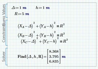

March 16, 2021
it worked, thanks
March 16, 2021
Note that you need only three guess values, when solving for three variables. (Delta, h and R).
The values for X.A,B,C & Y.A,B and C are 'knowns', and can be placed above (outside of) the solve block.

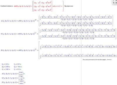

March 16, 2021
If you need to solve more problems like this, you can take the following approach:
