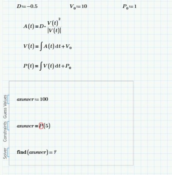

Hello
I am pretty new to mathcad. please help me to solve this .

Well, there are a few things that need to be corrected to make the solve block work, but do you really need a solve block?
Attached file (Prime 4.0) explains.

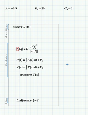

I tried the way you suggested however i am unable to get the answer any suggestions where I might went wrong?
September 28, 2021
Two things.
1) You can include the worksheet to help solve your problem.
2) Can you give a little more insight into the problem you are solving?
