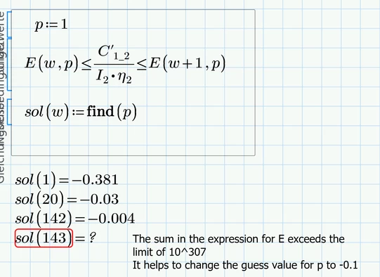

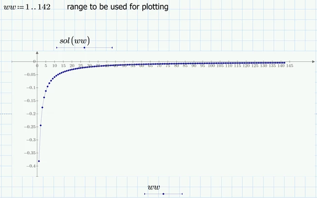

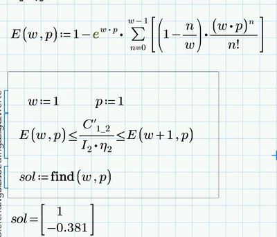

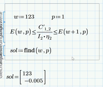

You may do it that way
But whatever guess value you chose for w, it will be returned unchanged, only the (negative) value for p changes
So you could as well use the solve block to just find p dependent on w:
p as a function of w:
