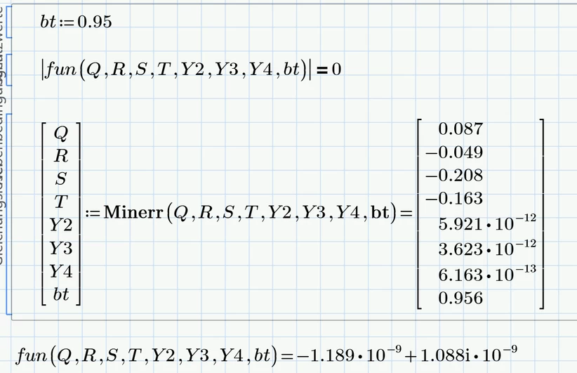

I am trying to get the answers using the minerr in solveblock but somehow minerr seems to be doing nothing. Can somebody provide any insights on this what I am doing wrong ?

The guesses you provide yield a non-real result.
Try to choose guess values which make the expression you want to be zero a real value.
Or, if appropriate, you may use the absolute value:
Furthermore I would suggest that you define a function for the constraint
and use this function in the solve block and to check the result:
Of course you cannot expect a unique solution - you provide just one single equation but have eight variables to jiggle around!

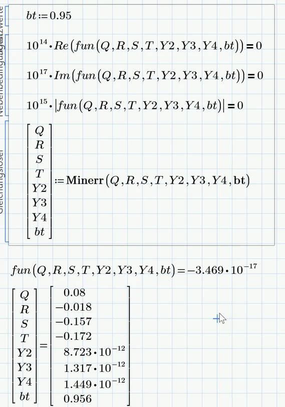

Feb 15, 2025 9:02 PM UTC
Your equation is VERY sensitive wrt small changes in the input values.
I played around a bit, formulated three constraints, demanding the Real part, the Imaginary part and also the absolute value to be zero and "weighted" these constraints by multiplying with various powers of 10.
Here a result with a real valued function value pretty close to zero:
Prime 10 sheet attached
