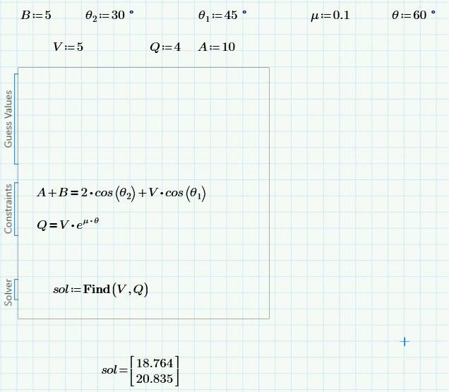

I am trying to get the values using solve block but it is giving me error which does not resemble anything. Could someone please help me here

Hi
Define A
cos() is a function with one parameter inside brackets..
terryhendicott
Hi
Define A

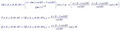

23-Emerald V
Or:
Then fill in the values for A, B etc.
