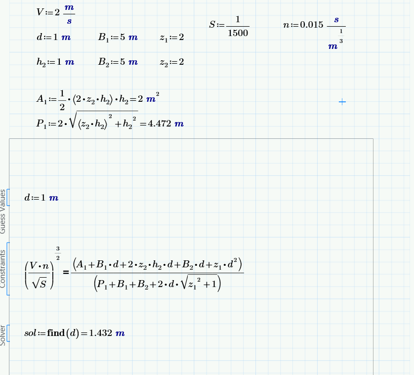

Can someone please help me in finding the mistake in the attached solve block?
TDP
You don't need all the parameters inside the solve block if you are not solving for them.

Sorry, worksheet attached.
Mike
dtumula1-VisitorAuthor
Thank you very much for the help.
