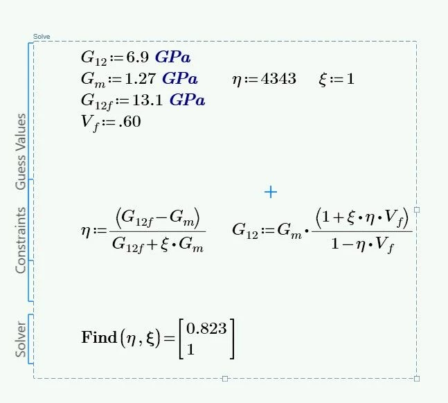

When i change the value of E in solve block it changes the value of both E and n , but when i change the value of n , nothing happens. Here n and E are two variables i need to find. Other values on left hand side need to be fixed.
If you know any other method to solve, please let me know

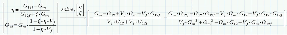

Use the symbolic equal sign (Ctrl+=) to define equations within the Solve Block.20170924_syseq.png

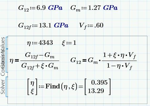

Thank you, but could you also explain why the values are changing when i change value of n and e ? is there any other method with which i can get stable answer.

Use please the symbolic solution
