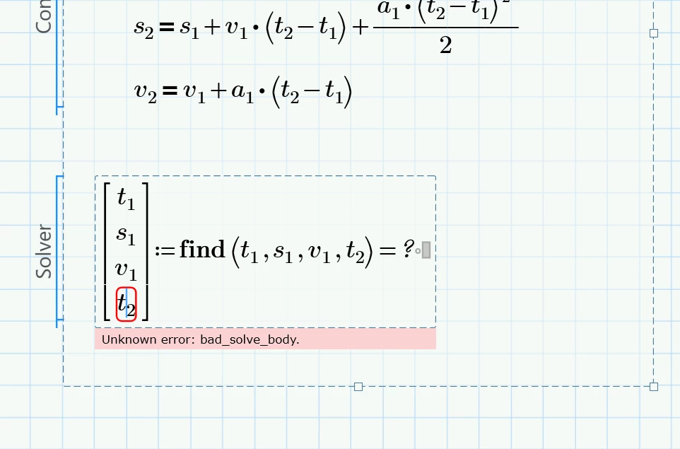

My students and I use Mathcad to solve problems of dynamics. My students this year (prime 10.0.0.0) come sometimes across an unknown error when using a solve block. The error mentions "bad solve block"; refer also to the screenshot. I have never come across it before and I have no clue what the reason could be for this error.
After retyping the equtions and the "find" command, the solve block executes correctly. But I don't see a difference between the original solve block and the one after retyping it. So it stays a mistery why one time it executes and the other time it doesn't.

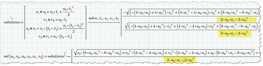

Solving the system symbolically shows that you run into troubles (division by zero) if a.0 = a.1

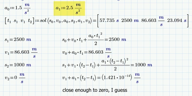

Here I changed a.1 from 1.5 to 2.5 m/s^2 and the symbolics seem to provide a valid solution:
Unfortunately the numeric solve block still fails 😞

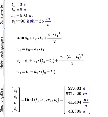

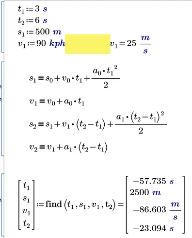

The problem is the inline evaluation in the definition of the guess value for v.1.
Delete it (and evaluate in a separate region if necessary) and the solve block works OK - at least if a.0 and a.1 are different!

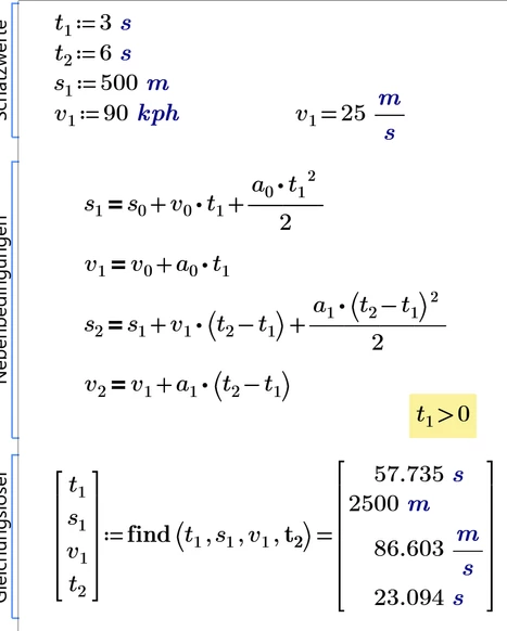

As we have seen from the symbolic solution, there are two sets of solutions stemming from the underlying quadratic equations. In the solve block above we got the (presumably undesired) solution which includes negative values.
To get the other set of solutions you may either provide better guess values (even t.1:=9s will do the job with the values given) or you add additional constraints, for example t.1>0
