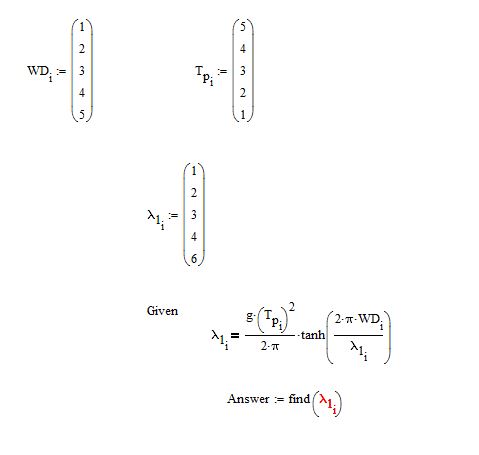

Hi, I have a problem with using solve block find function multiple inputs, May I know what is the problem? thanks
December 18, 2015
You can't use a solve block like that. Make the solve block a function:
Answer(WD,Tp,lambda1):=find(lambda1)
Then call the function for the different values of WD, Tp, and lambda
