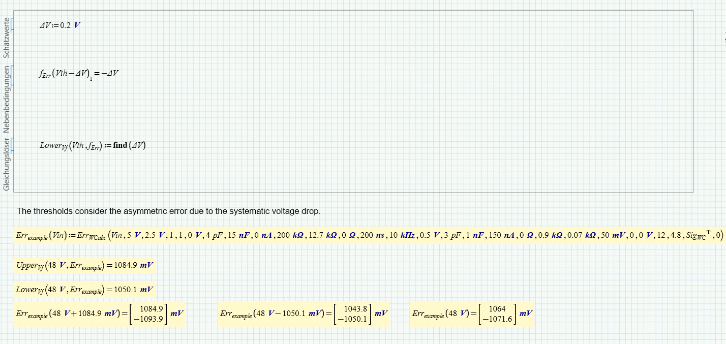

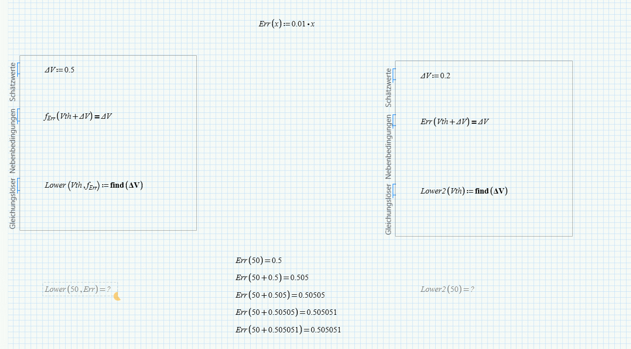

I implemented a solve block, which worked with Prime6. Now with Prime7 it does not find a solution anymore. I reworked the problem using a simpler function to make it easier to understand and even this easy equation is not solved. Unluckily I have a new computer for some weeks, with a completely new installation and only have Prime7 installed.
Both versions of the solve block do not work. I know, that the equation could be solved easier, I just used the solve block for demonstration (see attached SolveBlock). In my application the function is much more complex and it worked with Prime6 (SolveBlock_original).

Manfred_F12-AmethystAuthor
Dec 12, 2022 1:16 PM UTC
Hi Terry,
when you look into my example on the right side (Lower2). This did also not work. By the way you can use a function as a parameter, as it was done on the left side. In this case you can provide the function as a parameter to the solve block. As I said this worked with Prime6 as you can see in "SolveBlock_original"

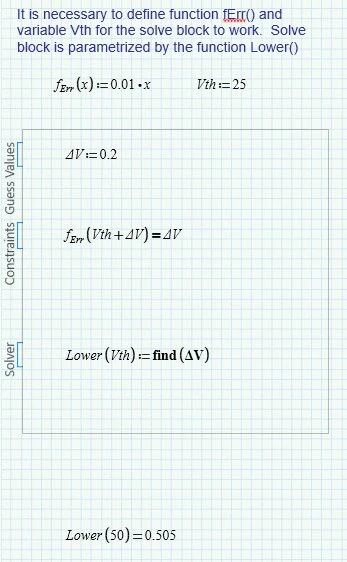

I opened the file with Prime 7, and saw no results.The Stop All Calculation and Calculate buttons were greyed out.
Then I pressed the Auto Calculation button and promptly got:
As well as the result for Lower2(50)=0.505.
Can't show here because the forum software is not helping by refusing to show pictures.
Anyway, is this what you hoped to get?

Manfred_F12-AmethystAuthorAnswer
Dec 13, 2022 6:30 AM UTC
Thank you all for helping.👍
Today I opened the file and it worked at once. Maybe I had no licence or whatever, but Prime was calculating without end showing the yellow circle for at least 15 minutes yesterday. I tried it several times yesterday with the same result. Also the original calculation now works.
For the future it would be good to get an error message or whatever in such a case.
