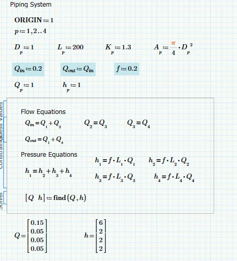

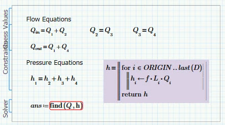

I'm looking at pipe flow in a series/parallel configuration.  Each pipe/flow/head is an index.  It works if I type in all the head loss equations individually, but I'd like to use a loop to automate it.  But, Mathcad doesn't seem to like it.
This works:
This doesn't work (no solution found):

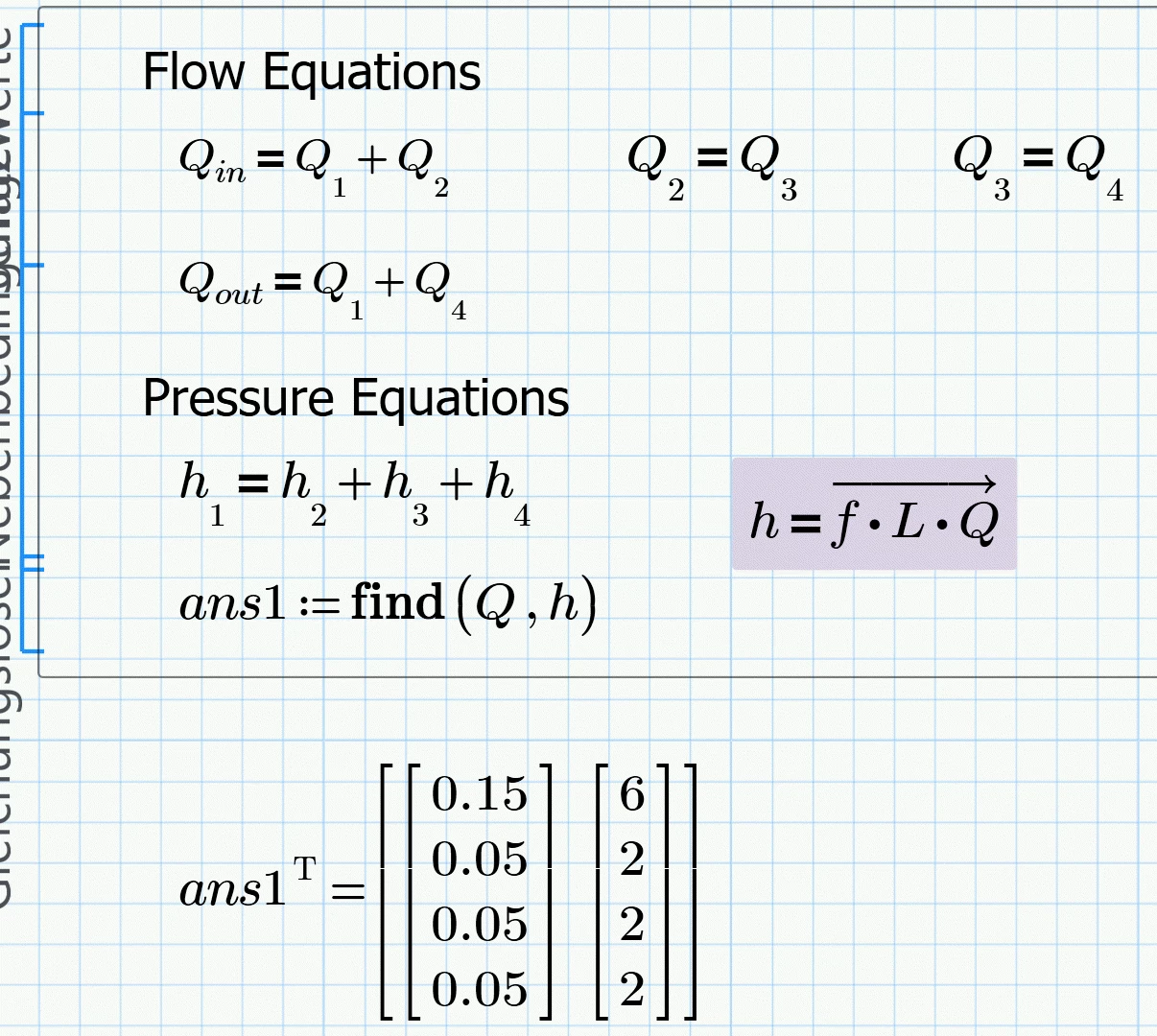

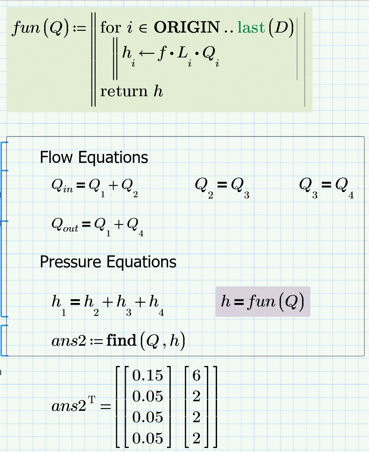

Here are two ways to make it work. The first one uses vectorization and is the preferred one.
Werner_E25-Diamond IAnswer
Any way to get it to work?
DJF16-PearlAuthor
Ah, excellent work as always Werner.  I actually used the fun(Q) solution - as I need to add Moody factors and whatnot.
