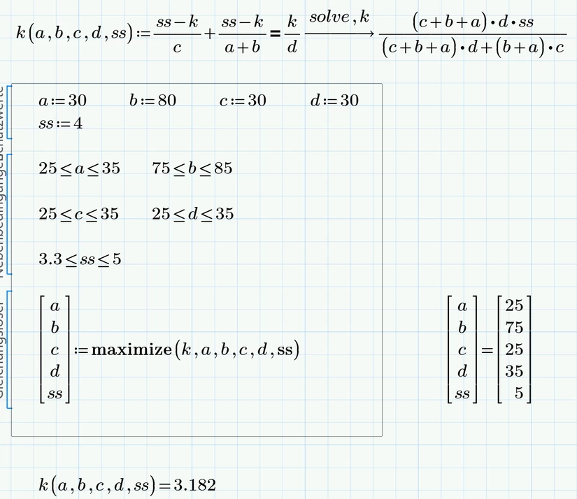

Werner_EAnswer
Are you looking for something like this:
Obviously a,b,c should be as small as possible while d and ss should be as large as possible.

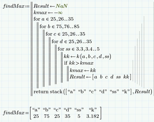

Werner_E25-Diamond IAnswer
But in case a,b,c,d must be integers and you only want to cycle through the values with the given steps only, you may do it in a small program using nested for-loops:
