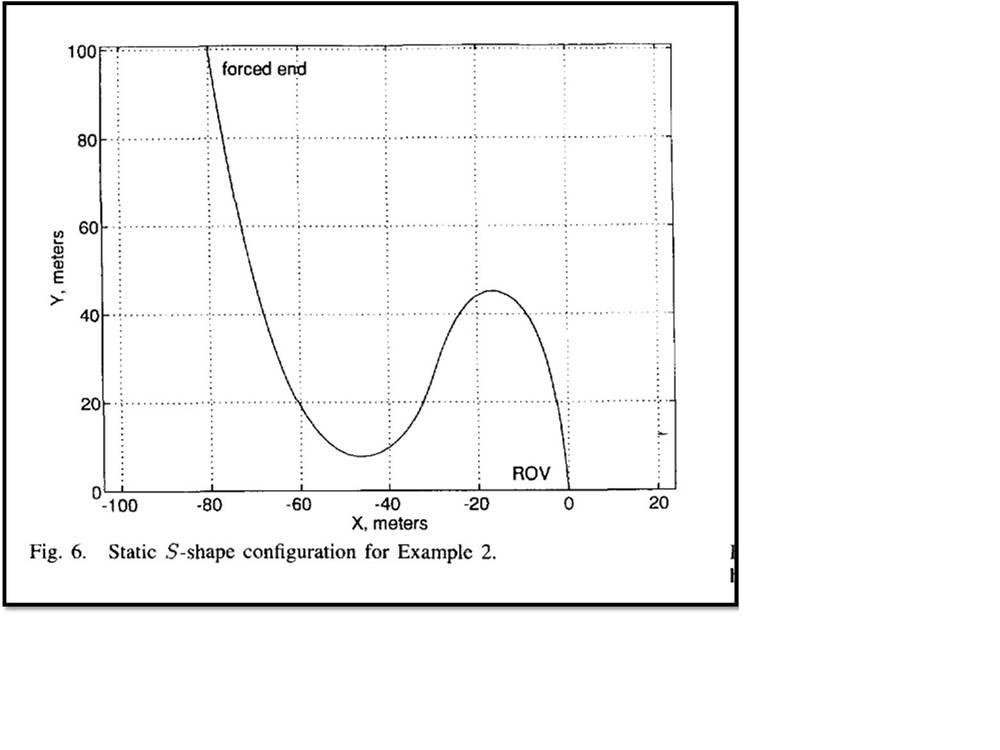

I have a boat which is supporting an umbilical (cable) - which is supplying the electrical power and communications to an ROV (remote operated vehicle) which is several hundred metres below the surface of the water. There is a bit of a twist to the problem - because the ROV operator wants to attach weights to the umbilical (at location number A - over maybe 50m of umbilical length) - and he also wants to add small buoyancy modules (at location number B - over maybe 50m of umbilical length). The ROV operator wants to do this - in order to isolate the ships motion from the ROV - so the shape of the umbilical will be an "S" shape (rotated through 90 degrees) - when looked on side ways.

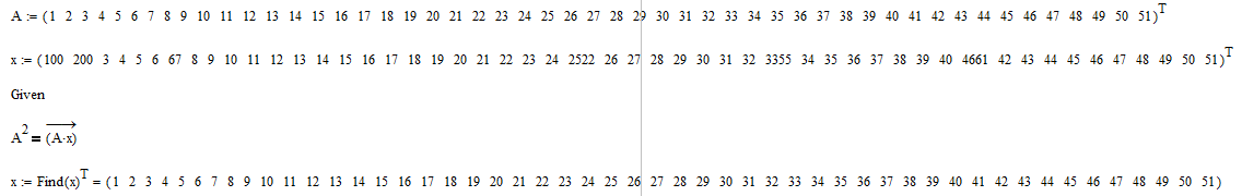

Gordon Durward wrote:
  1. how to resolve the 50 unknown apparent limit on the Find function
Find(x) where x is a vector
February 3, 2013
I have check it
23-Emerald I

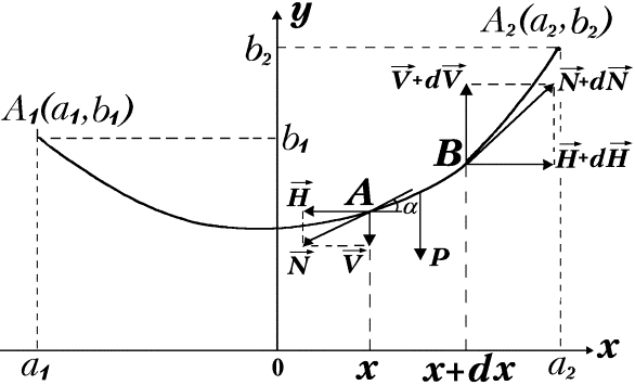

One picture for the first step of the problem solution:

This may be useful:
http://sci.tech-archive.net/Archive/sci.math/2007-02/msg02379.html
for demonstration:
http://stackoverflow.com/questions/10872464/catenary-with-manipulate
