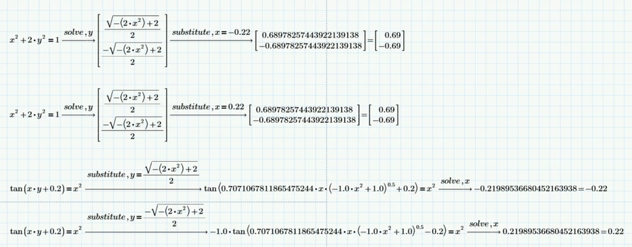

I took one of the equation from this topic https://community.ptc.com/t5/Mathcad/Newton-s-method/m-p/949155#M211771

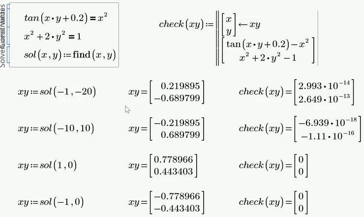

I see that Solve Block does not give all the solutions of the system equations only by trying only one pairs of (x,y) guess values:
And we need to change manually the guess values in the hoping that we will get the all solutions. But what to do when we do not have other alternatives to know that the system of eq has more one solution and when with the limited guess values tried we got the same solution?
But my questions are:
1. Why Solve block gives solutions like x=-0.779 and y=-0.443, why other method gives x=-0.22, y=-0.69, and so on.
2. How one can be sure while using Solve Block he finds all the solutions of when solving the system of equations? As I do not like the solution given with solve block that we cannot be sure that we found all the solutions, as one cannot be sure that he tried all the variants for guess values.
Without changing the guess values we conclude that this system of equations has only one solutions as was presented in the Newton's method topic from where I took this example, but relying that the above systems of eq has only one solution is wrong, as we can see from below (total (x,y) pairs of solutions are at least 4, and not only 1 as the solutions of this system of eq was presented in Newton's topic).  And moreover we can see that with solve block we can get more than 4 pairs of (x,y) solutions.

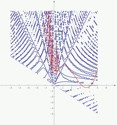

@Cornel wrote:
In this case I do not know how to make the plot,
Here you are. Every point of intersection of the blue and the red "curve" is a solution 🙂
but in above set of equations I do not know really how many set of (x,y) paris of solutions there are..
Neither do I. Here are a few solutions out of a list of 104 solutions (and this list sure is not complete, I guess).
Have fun!

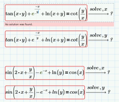

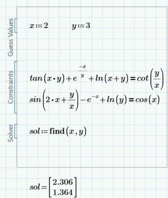

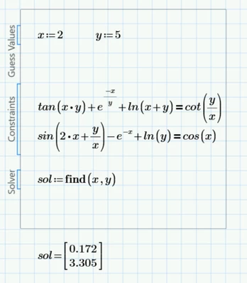

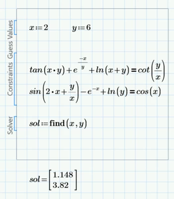

For example look at this another example:
In this case we cannot rely on the above other method like I showed in the first post:

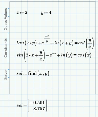

But by using the solve block:
Now if we change again the guess values:
And so on, we could continue infinitely, without knowing if we found all the solutions.
For example let's say that we want to find the solutions of this system of equations for:
How to do?

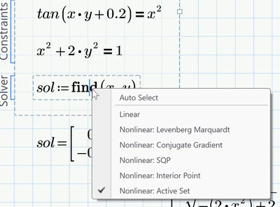

In real Mathcad and even in Prime starting with version 10 you also can choose from a menu the numerical algorithm which should be used - changing the algorithm may return a different solution using the very same guesses sometimes.
Choosing "Conjugate Gradient" returns the 0.779/0.443 solution pair in your first example.

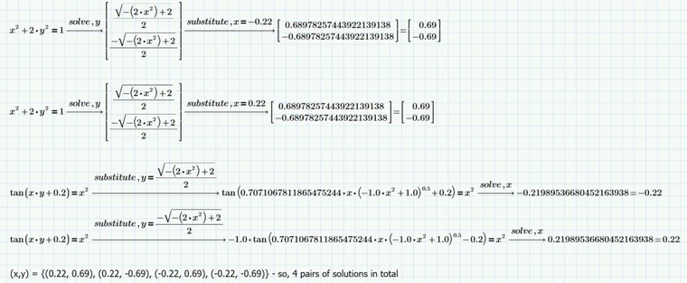

May 13, 2024 3:56 PM UTC
@Cornel
WRONG!!
There actually ARE four solution pairs, but you just found two of them. Two of your solutions are NOT solution to this system! Make a check!
The solutions are:
Cornel19-TanzaniteAuthor
May 13, 2024 4:16 PM UTC
Yes, I forgot to check what pairs of solutions are indeed the solutions for this system.
But then why with this method fails to find all the solutions of the system? (that is, all the solutions, even if some prove to be the right solutions for the system, and others not). I did not see any problems in how the solutions of the system was obtained. This method cannot be used to find all the potential solutions?
