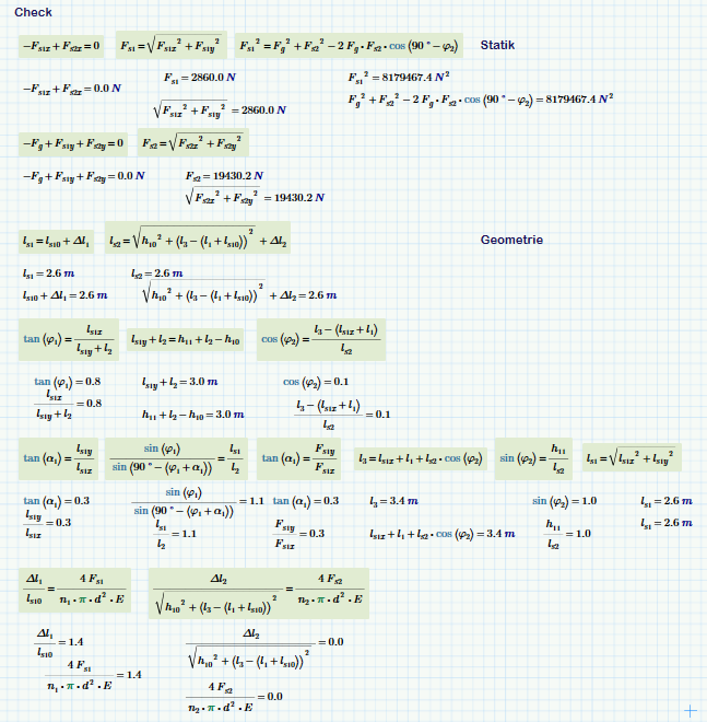

I have to solve a mechanical problem (dimensioning steel cables) with the solve block including 18 equations with 18 unknowns:
It is required that the length change, the number of threads and all forces, etc. are calculated with the solver.
Please see the sketch (you can doubleclick the .exe file to view it, it's an e-drawing file) and worksheet in attach.
The Problem is: I have as many equations as unknowns and when i change the guess values, i get always different results.
Are my equations right, and do i define something double or contradictory?
Any help will be appreciated.
Thank you very much for your efforts.
Volker
DJFAnswer
I believe you have not formulated it correctly.  If you get multiple answers that usually means there are multiple answers.  Mathcad stops as soon as it finds one solution.  Running a quick check of your results shows that all of the constraints are solved properly with your results.  Maybe TOL or CTOL would make a difference, but I doubt it.  Check the results to see what isn't making sense.

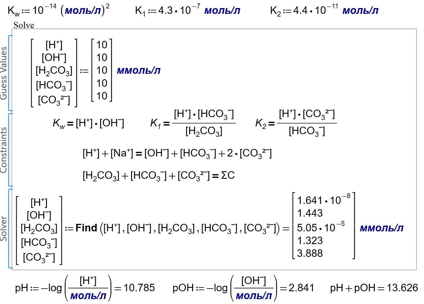

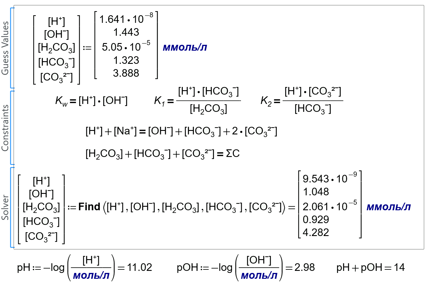

Try please copy the answer and input it as guess value.
Better to have the guess value not as x:=1 y:=2 ets but as two vectors.
As here for example
The second answer is correct!
