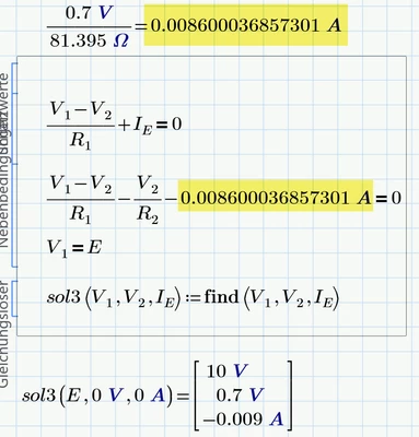

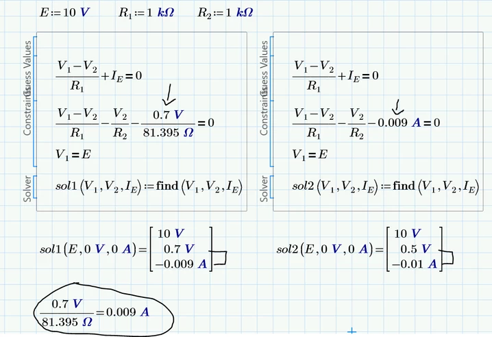

As I have this equality:
I see that I received 2 different answers out of the solve block for V2 and IE, though both systems of eq are the same...V2 and IE should not be the same for both cases?
Werner_EAnswer
Werner_E25-Diamond IAnswer
