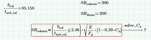

Good Afternoon Community,
Need some help with solve block with Find function. Please see attached.

hcol/tweb_col is 85.158 so always > 2.46 so first bracket is always zero so Prime cannot solve equation.
Check the equations?

Good that you attached the worksheet, no need to zip it, though.
You should state which version of Prime you are using (8 in your case) to prevent that you get an answer in Prime 9 or 10 (that you cannot open).
Now to the problem.
The part
in your expression is a boolean equation, it essentially asks if the equation is true or false and results in either 0 or 1 (false or true).
Now with:
it always returns 0, so the rest of your expression doesn't matter anymore.
The same goes for:
Your symbolic expression:
Assigns the result of
to the variable LucMeekes_8-1742375813532.png.
Essentially the part
should be valid sets for the answer), but Prime refuses to come up with that answer (fortunately?).
Review your equations.
