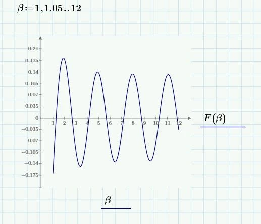

terryhendicott
Nov 23, 2024 5:24 PM UTC
AFAIK you need to use the function a number of times to find the roots using different ranges.  You can use the root function in a Prime program.
You need to plot the equation to get a gauge of what ranges to use.
Cheers
Terry

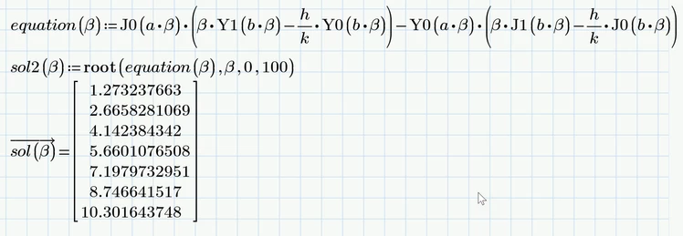

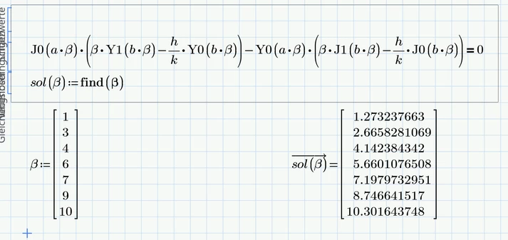

Nov 23, 2024 6:46 PM UTC
You have to use vectorization (the arrow over the expression, to get what you are looking for
Vectorization can be done from within the menu or using the appropriate keyboard shortcut.
Personally I would rather prefer to setup a function which gets the solution for its scalar  argument beta and then call that function vectorized with your vector as function argument.
You may either turn a solve block into a function
or use the root function to do so
A numeric method in Prime will always just return one result depending on the given guess value and finding good guesses may be tricky sometime. A guess near to an expected solution might return another solution which is far away. And of course different guesses might result in the same solution.
Which way you choose, vectorization is always the key to success. Vectorization means that an equation or function which is written to deal with one single scalar argument can be used with a vector instead of the scalar and the elements of this vector are used as the scalar value

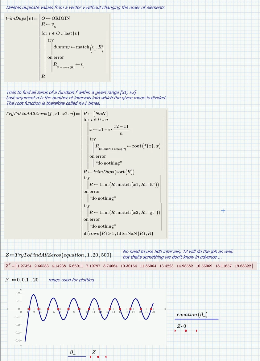

Nov 23, 2024 7:50 PM UTC
According finding all solutions of an equation within a given range, you sometime may have luck using the symbolics.
Sometimes its necessary to provide all values with integers only (83/100 instead of 0.83, etc.),
sometimes adding the modifier "fully" helps, sometime using the modifier "assume" (e.g. assume, 2<x<7) helps to get all solutions within a given range.
I had no luck doing so with your equation (or I was not patience enough to let the symbolic calc finish - it seems to run endless).
Here is a function which tries (no guarantee for success) to find all zeros of a function within a given range by using the root function with a lot of guess values (the last argument of that function), collecting all results, sorts the result and deletes duplicate value and also values which are outside of the given range.
The function works pretty well and fast with your equation.

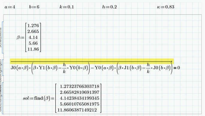

23-Emerald V
Nov 25, 2024 11:11 PM UTC
You define a value for kappa, but it's not used.
The roots to your equation appear to lie at a distance of about 1.5, starting around 1, so we can generate the guess values for beta:
Note that these values are (slightly) different from the ones in your table. Accepting the symbolic result (2.665....) as truth for the second root, I had to set TOL to 10-14 to get a matching numeric result.
