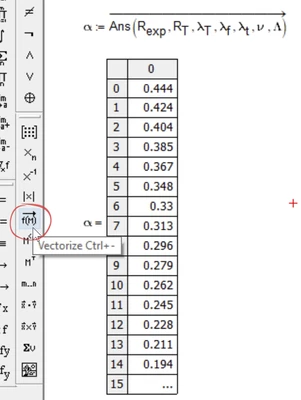

I apparently do not understand how to use a function defined in a solve block to get results for a range (vector) of variables.  It works for a single input, but not a range of inputs.

When you have a function which is made for single scalar inputs and you would like to feed vectors of values, you always should use vectorization (even though sometimes it is not necessary - depends on the calculations done in the function).
Thats the arrow over the expression and you can find it on the matrix palette or use the appropriate keyboard shortcut.

Thanks much Werner.  Didn’t mean to shout.  I’m 80 years old and accustomed to using upper case for titles.  I do these Mathcad projects to keep dementia away and to”keep me out of bars at night.” 🤣
I really appreciate your help.  You are always very helpful.  I’ll try to remember the upper case thing.
