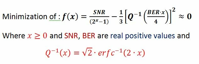

Dear all,
I need your help to solve this minimization (by symbolic calculation) using MathCAD Prime 3 that I have and use at school.
In ordrer to be clear, I attached a picture of what I want to solve. Note that both x, SNR and BER are real positive values.
I will be happy with your help.
Bests,
Max Fréjus

‌Thank you M. AlvaroDiaz for you return. Ofcourse, May be I need to reformulate the problem. I understand what you mean. In fact, f(x) is obtained from the difference between two components that are supposed to be equal to each other. THE CONSTRAINTS I have are like these: x is the variable which is strictly positive; SNR and BER are constantes positive values that I can change to emulate my model (they are all known).
Like I Said that I have two components in terms of variable x that are equal together, to solve this by symbolic calculation with Mathcad Prime 3 (I can do it numerically with matlab), I propose to minimize ther difference which I called f(x) to check the expression of x that will give me or approximate f(x)=0.
That is what I need to do, if I was Clear by my explanation. Hope that information Will Help you to understand the  problem.
thank you and best !
Max

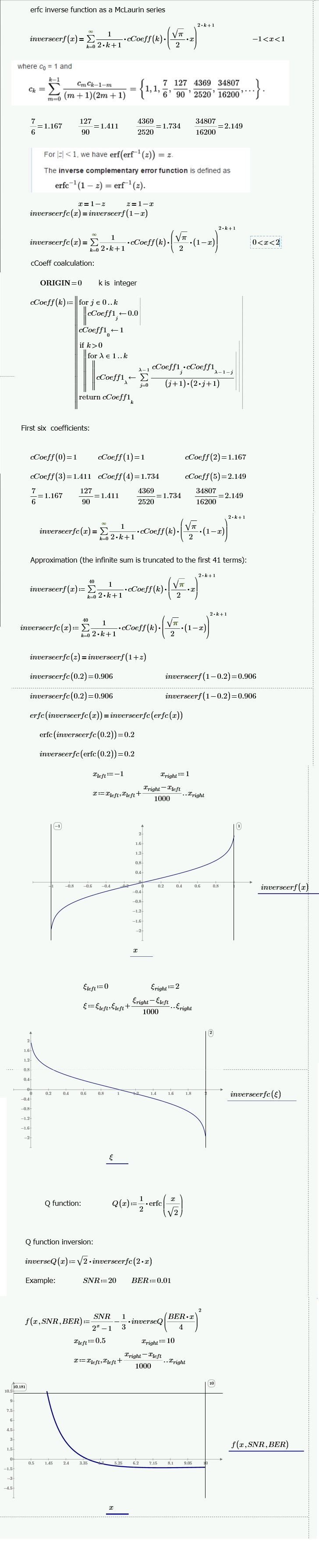

Hi Max. There are no hope to have a symb expression for that. First, you need some one for inverse erfc, and I don't know any one. As Valery says, only numericals.
In general, if you have looking for x that makes m(x) = n(x) what you need to minimize is abs( m(x) - n(x) ) or something else like squares, avoiding negative values. If not, the minimun could be - infinity.
In the picture, the numeric implementation for the inverse of erfc in mathcad. If you want a symbolic expression for its derivative, please check this link: Wolfram|Alpha: Computational Knowledge Engine . Notice that substituting the minus by an equal don't give any answer.
Best regards.
Alvaro.

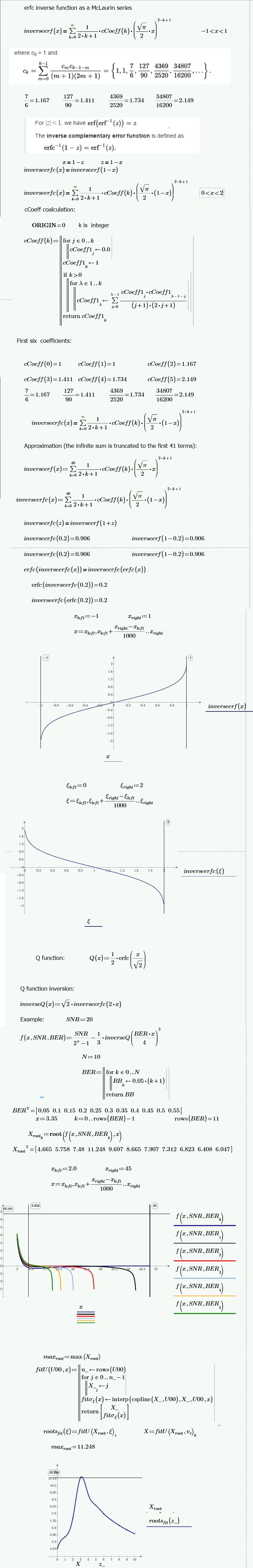

Hello Max. F.
The picture represents  only the first part of the solution of the problem which is to be checked.
Indeed, let me know if I'm on the right track. Moreover, you may also continue for yourself.
Greetings.
FM
Hi F.M. By root finding, I get ierfc(0.2) = 0.90702.
Best regards.
Alvaro.

All your help is real greatful. Sure, like M. AlvaroDiaz said, I have a mistake in my formulation. As I have something like this : m(x) = n(x), I need to minimize in easy way, f( x ) = abs( m(x) - n(x) ) or something else like the square method. In my case, it is  --> f( x ) = abs( m(x) - n(x) ) where : x is the strictly positive variable, m ( x ) = A/(2^x-1) ;   n ( x ) =1/3*2*InverseErfc(B*x/2)^2 ; and  A, B real positive values.
