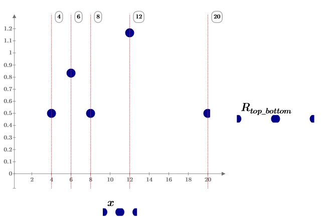

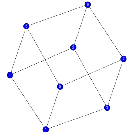

Diagonal resistance of regular polyhedron. R(4)=1/2, R(6)=5/6. How about R(8), R(12) and R(20)?

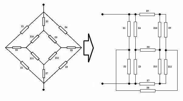

A simplification of the network topology allows you to easily apply Thevenin's theorem:

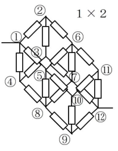

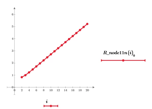

September 2, 2020

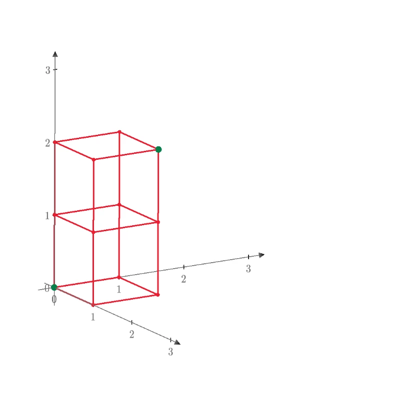

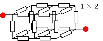

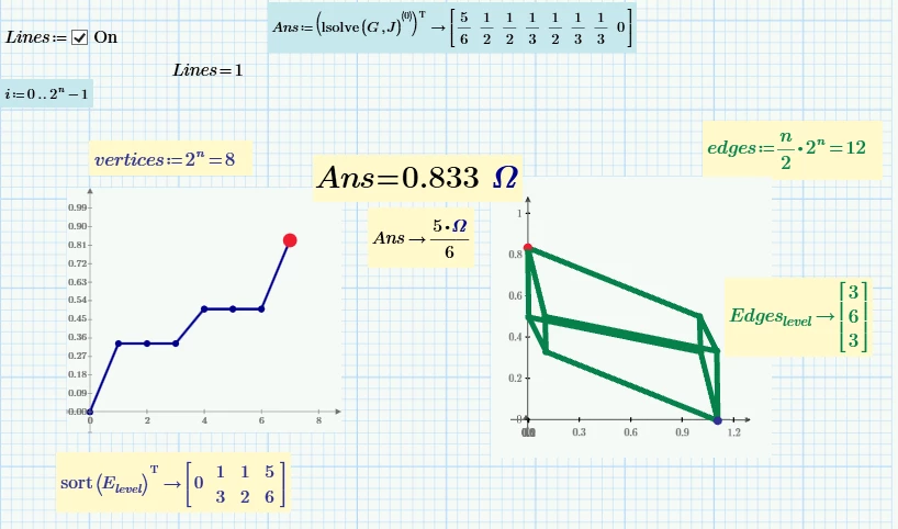

image.pngThe diagonal resistance of resistor 3D mesh is 5/6 ohm.
How about 1*2 3D Mesh?
Each branch resister is 1 ohm.

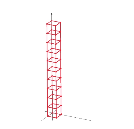

i=2:    1*1*1
i=3:    1*1*2
i=4:    1*1*3....

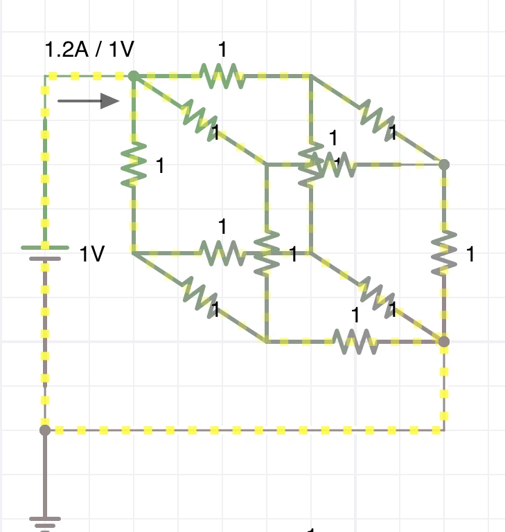

February 21, 2022
I don't know why every body went to town on this. You already gave the V and I  so R = 5/6 ohms.
But as an academic exercise - as others have given but more colourful pictures are here:
https://www.rfcafe.com/miscellany/factoids/resistor-cube-equivalent-resistance-kirts-cogitations-256.htm

February 21, 2022

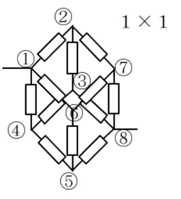

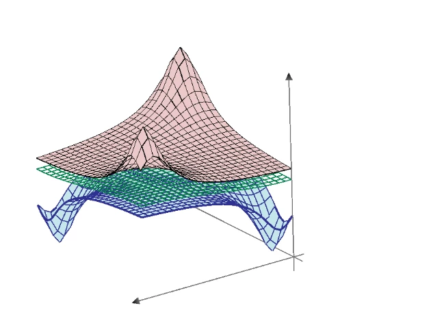

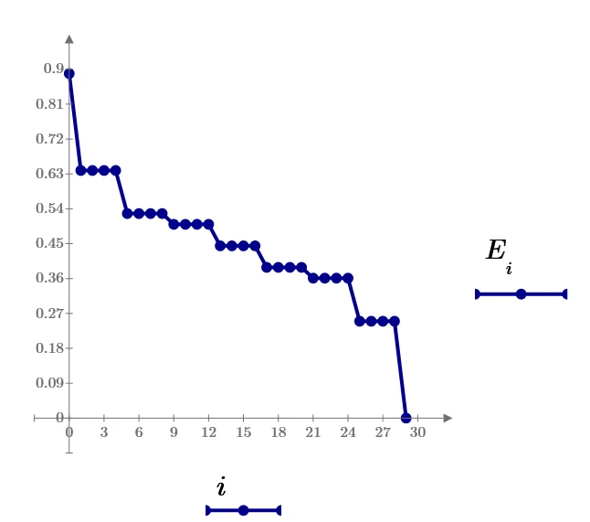

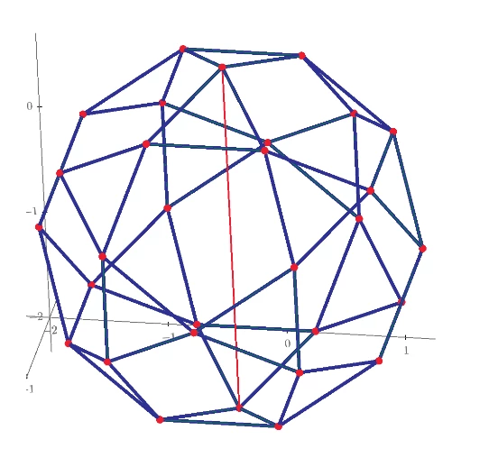

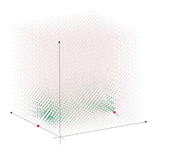

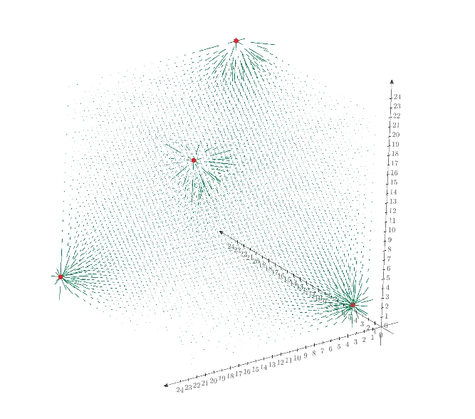

This is not solving 3D 1*1*1 grid resistor mesh only. Using Mathcad or other mathematical programs we can calculate more interesting resistor grid problems.
1/3+1/6+1/3 can not use if the grid is 1*1*2. I post many unique resistor grid problems here.  This time 60 node soccer ball resistor grid result is shown. Please try to solve it because I can not find any answer in WWW sites. Without using Math software, we can not solve such as R1-2 of resistor ball.
1*1*2                                                                                        1*1*1

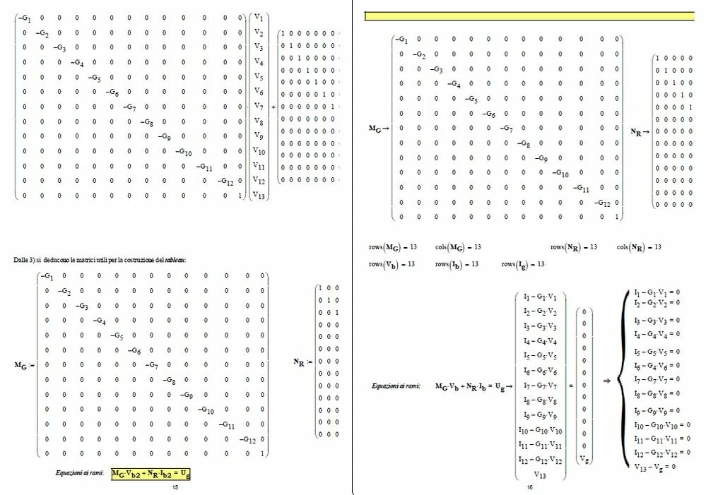

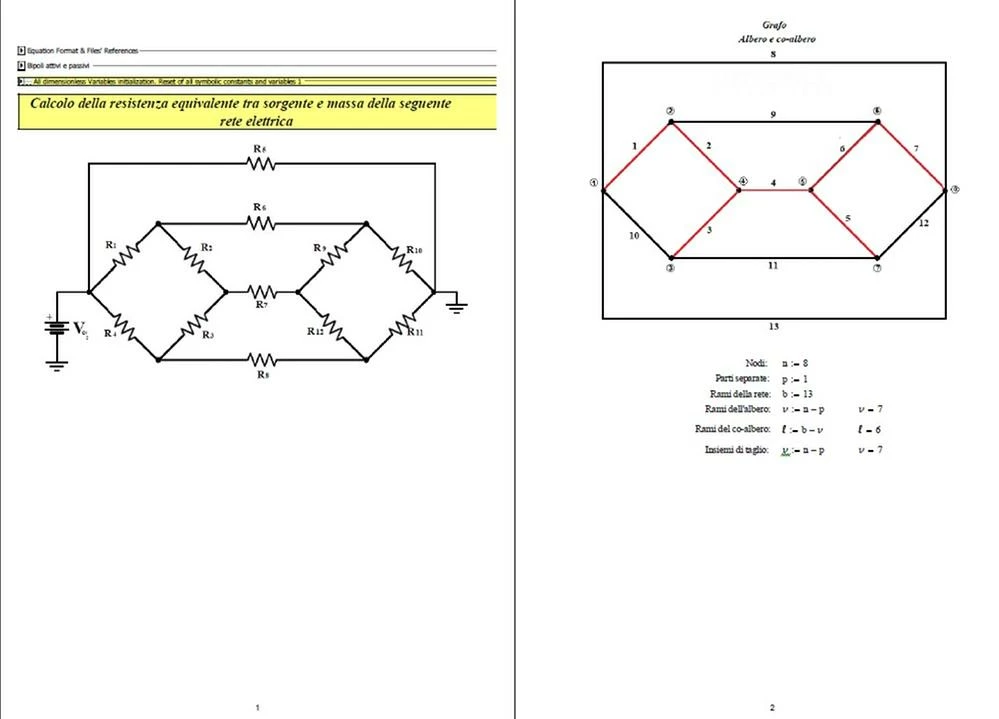

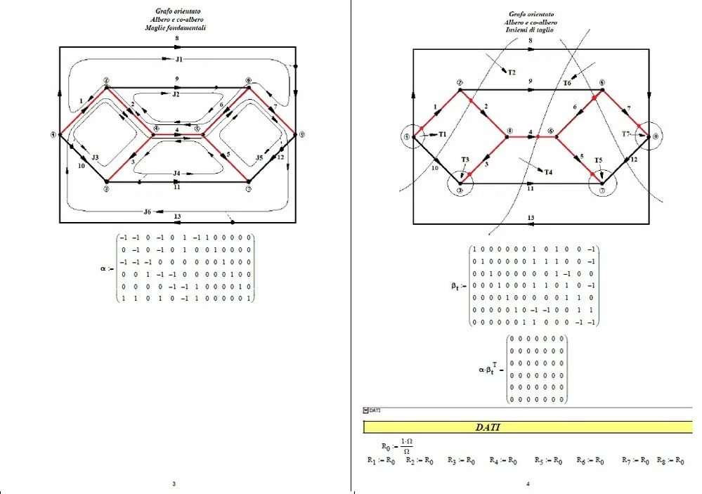

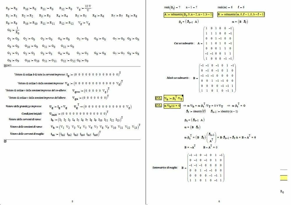

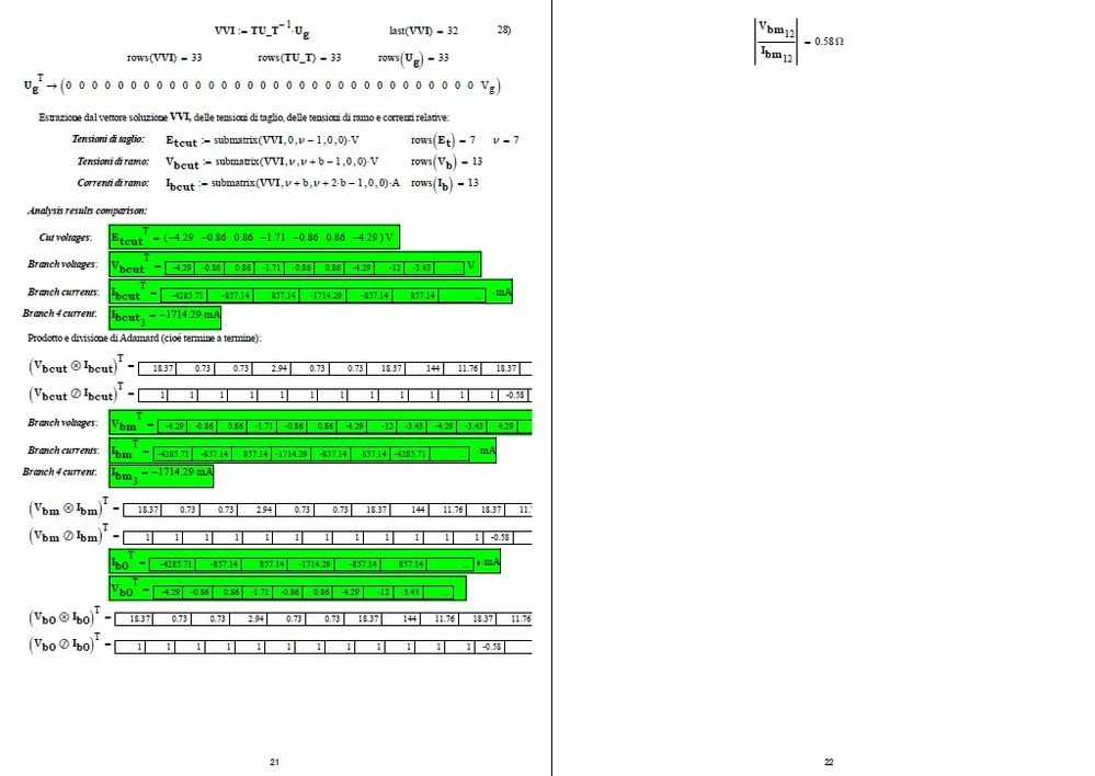

March 15, 2023

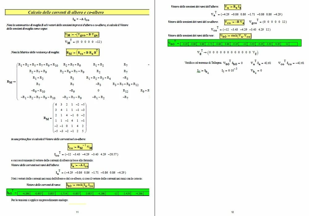

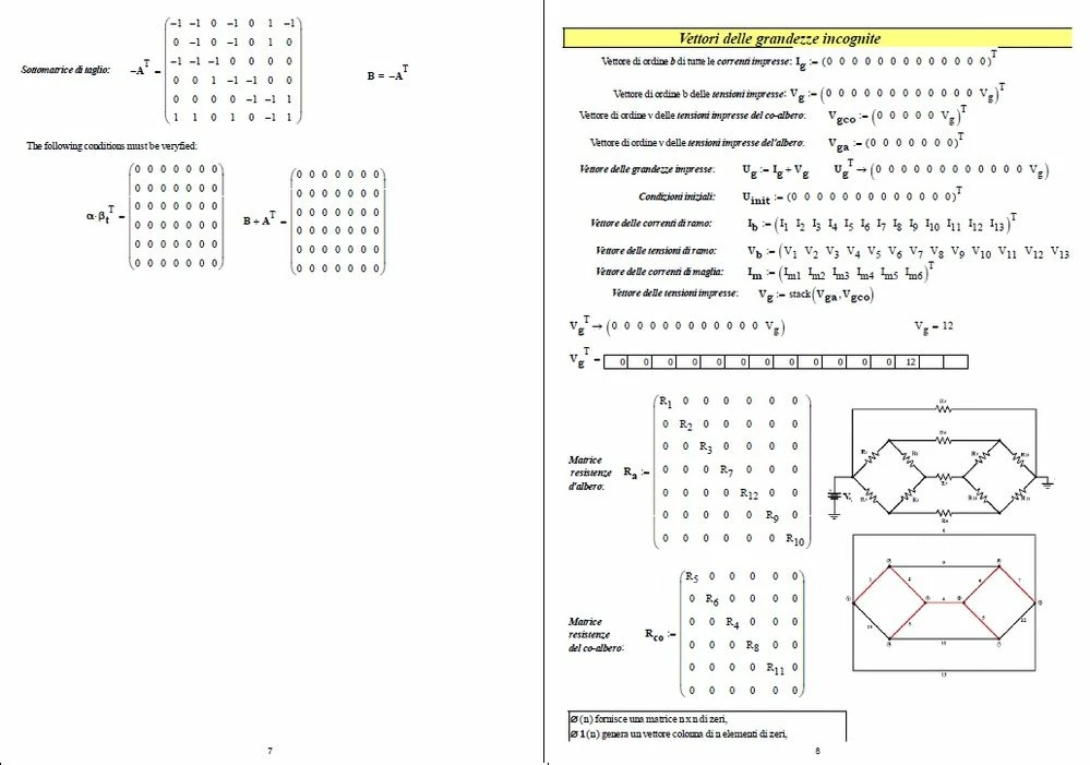

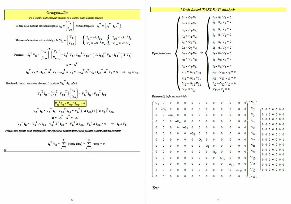

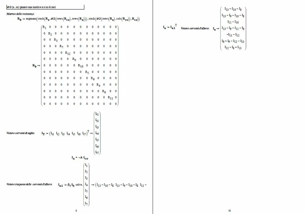

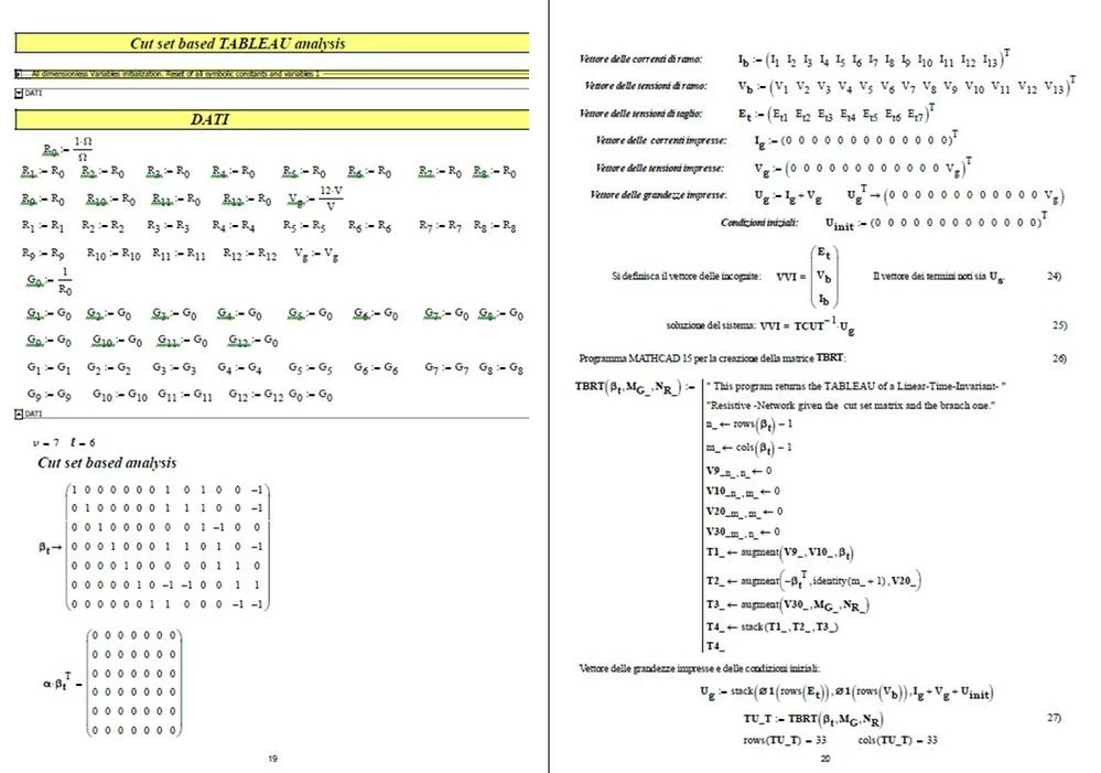

What do you think of my solution?  Maybe I took the wrong node as a reference point?
2RBridges 0.jpg2RBridges 1.jpg2RBridges 2.jpg2RBridges 3.jpg2RBridges 4.jpg2RBridges 5.jpg2RBridges 6.jpg2RBridges 7.jpg2RBridges 5.jpg2RBridges 9.jpg2RBridges 10.jpg

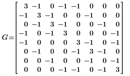

March 15, 2023
I will check your circuit. Please upload your Mathcad worksheet. I use Prime 9 to solve it.
I view your post and I understand this is 3D cube circuit with 12 one ohms to find the equivalent resistance of diagonal nodes. Node method is used to solve the circuit. I think this is the best method to solve the resistance.
t.t.
March 16, 2023
Undoubtedly, I made some mistakes. As for the theory, I was inspired by some texts including: "Linesr and non linear circuits" by L. O. Chua, C. A. Desoer, E. S. Kuh, for the construction of the TABLEAU matrix. You can find my worksheet attached.
Greetings

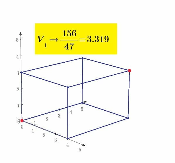

April 19, 2025

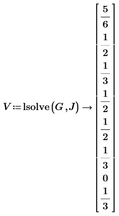

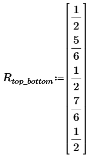

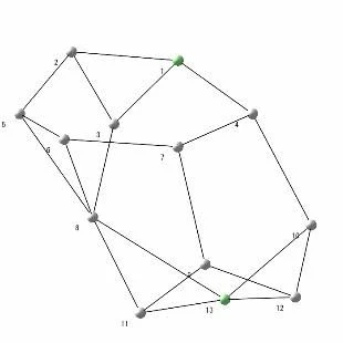

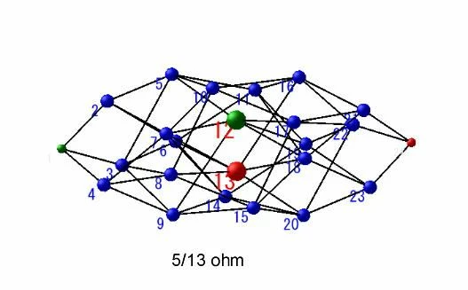

3.4.5 ohms cube.
1 ohm circuit by 1 ohms. Each 1 ohm has different current when apply 1A for 1 and 13 nodes.

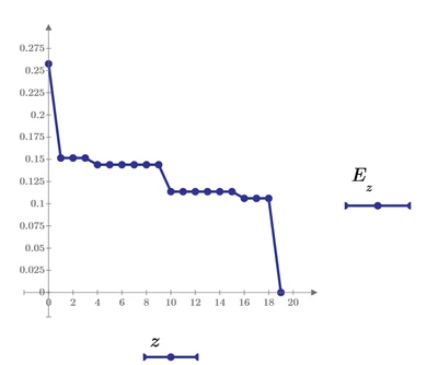

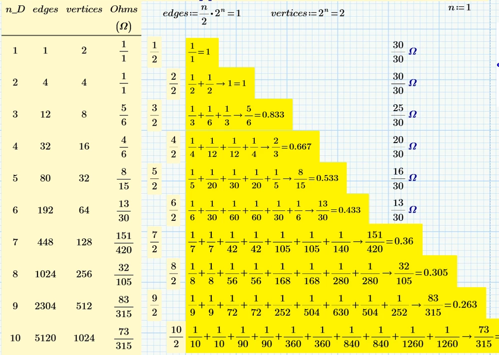

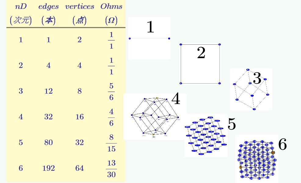

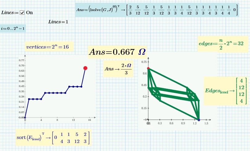

Diagonal resistances of n-D cubes. AI only knows 3D and 4D ones.
t.t.

January 24, 2026
Source and Image Credits: Ellenberg, J., Libedinsky, N., Plaza, D., Simental, J., & Williamson, G. (2026). Bruhat intervals that are large hypercubes.
New hyper cube circuit 2026.
t.t.

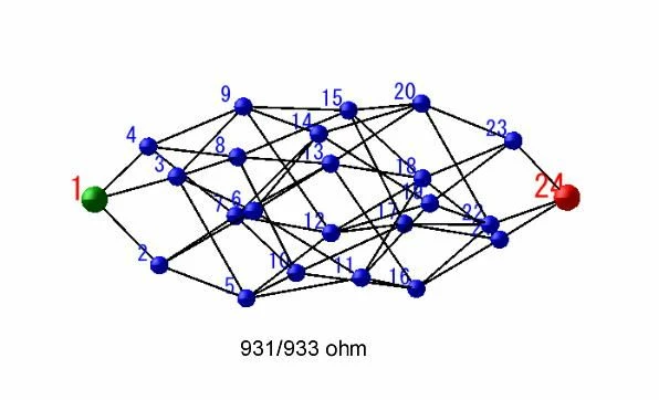

February 21, 2026

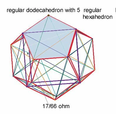

Diagonal resistance of Galileo's 12-20 cube cauldron at the Milan Olympics.
