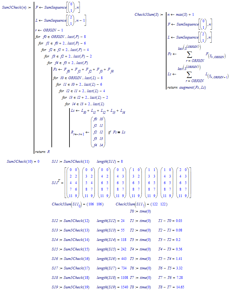

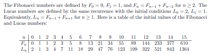

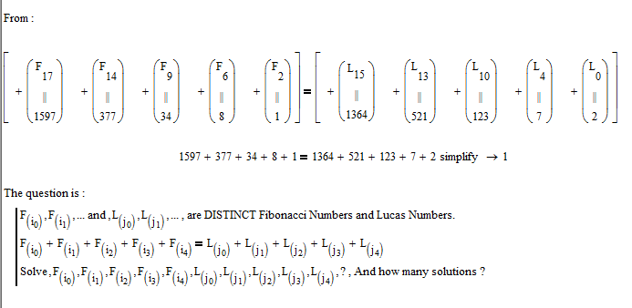

Hello Everyone.
   The question is : Solve, 5 of Fibonacci numbers  =  5 of Lucas numbers ?
         Thanks in advance for your time and help.
              Regards.

I'll dare the conclusion that therea are infinite solutions:
But I'll not calculate them.

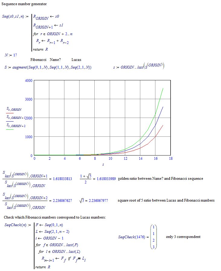

23-Emerald V
Nov 24, 2016 9:12 PM UTC
Not found within a reasonable range of numbers:

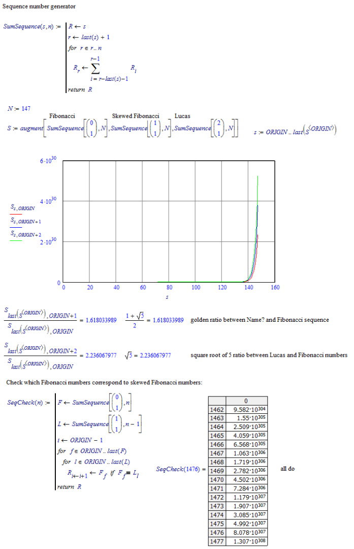

23-Emerald V
Nov 24, 2016 9:39 PM UTC
Ah, the second sequence gives skewed Fibonacci numbers:
lvl10720-TurquoiseAuthor
20-Turquoise
Nov 24, 2016 10:27 PM UTC
I'm sorry. I think my question, the above, is not clear. And my question would be :
   How many solutions ?
       Best Regards.
23-Emerald V
Nov 24, 2016 10:31 PM UTC
With DISTINCT you mean that i[0 and i[1 must be different, etc?
20-Turquoise
Nov 24, 2016 10:35 PM UTC
Yes, it is. And i[1 - i[0  > 1  (not consecutive)
