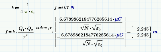

You need to use the boolean (comparison) equals sign.  You used the definition equals sign.

Attention entre e0 et eo dans la formule
I think its more like:

Aaron,
It is necessary to destroy voting equation (f: = Q1 * Q2) on your worksheet because it blocks all changes.

The Coulomb low is:
