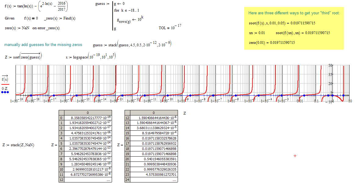

December 31, 2016
  The question : how many real roots does the f(x) = 0, the above, have ?
Looks like its quite a huge number 😉
Find also three different ways to get your "third" root.
Welcome to numerical algorithms! Ever so often they don't converge or are very sensitive concerning the guess values.
You may also chose among a couple of different algorithms^if you use a solve block! Right click on the word "Find" and then chose one of the three offered nonlinear algorithms or mess around with the options offered. You will see that most of the time Levenberg-Marquardt (which is the default) is the best choice.
Also the setting of TOL can influence the solver and setting it to a level too low might make the solver fail.
You can also see (look at the values in my vector Z) that different guess values often result in slightly different values for what sure is the very same solution. Numerical inaccuracies is something you have to live with when you deal with numerical approximations.

In case you are in search for other solutions to your equation, you might use the numeric solver(s) (solve block, root function). Of course you have to live with its numerical limitations.

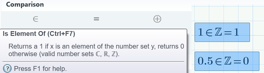

December 31, 2016
Simplest example
lvl10720-TurquoiseAuthor
20-Turquoise
December 31, 2016
Many thanks, Valery.
