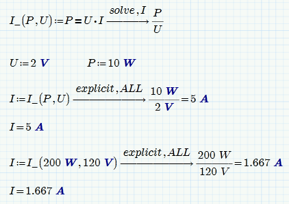

I know how to use solve to find an unknown character in an equation, but is it somehow possible to see the equation?
I have attached a picture. I would like Mathcad Prime to give me the second equation by typing in the first one.
Hope I made clear enough to understand.
If you add the unit A in your first equation, then x would be dimensionless 5.
Better let Prime handle the units.
I guess what you demand is not possible to achieve - at least not the very way you would like it to show up.
Thats the best I could come up with:
