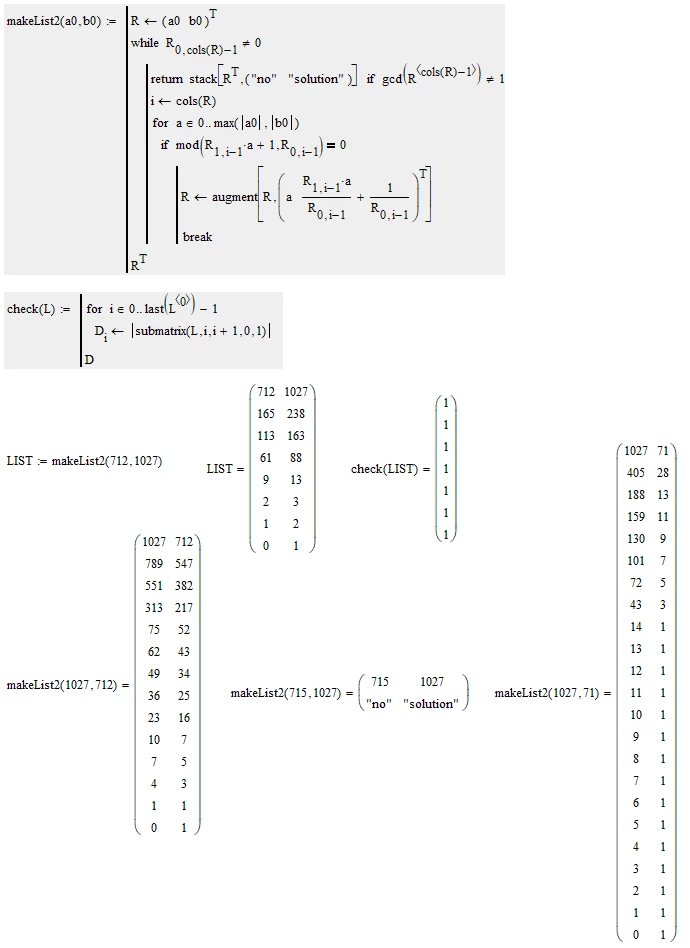

While cleaning up I noticed that I forgot to post the solution using Euklids algorithm. So before the file is deleted, I post it here.
Here we have no problem with numbers too high, as it seems.

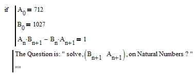

Sep 26, 2022 2:20 PM UTC
Your definition seems not define series of numbers.
Its NOT defined what the NEXT pair (a1; b1) would be.
Is it (165; 238) or should it be (877; 1265) or would you rather like it to be (1589; 2292) ?
The general solution is a.1=165+k*712 and b.1=238+k*1027 with k being any integer.
If you settle for the smallest positive numbers, a first hack could be
Not much error checking or whatsoever and the 'math' method used is not Euklid or congruences but simple pure brute force 😉

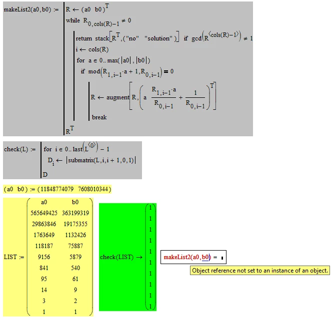

lvl10720-TurquoiseAuthor
20-Turquoise
Sep 27, 2022 1:31 AM UTC
  With big numbers then:
(Attach ***.xmcd please)
Best Regards.
Loi.
Sep 27, 2022 3:39 AM UTC
Interesting error message. No idea what it should mean and why it pops up.
Solution: Don't use too high numbers 🙂
Werner_E25-Diamond IAnswer
Oct 5, 2022 4:43 PM UTC
