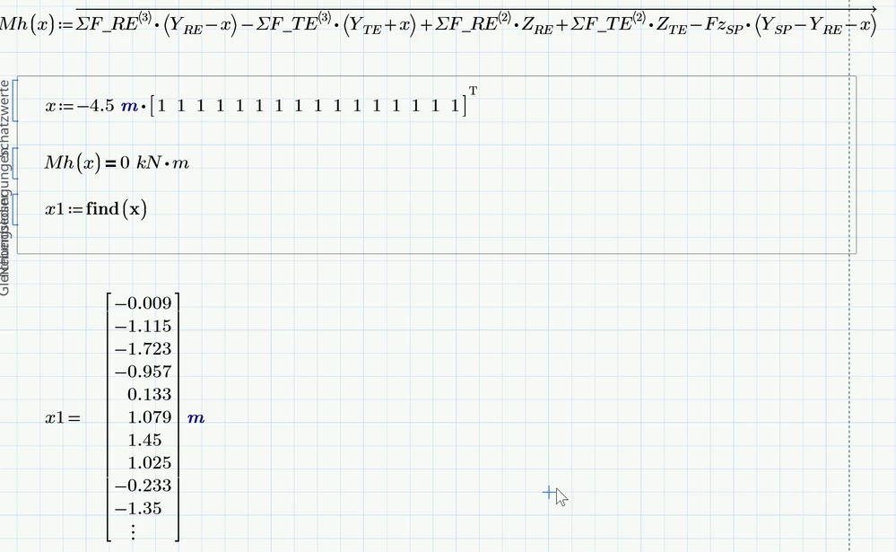

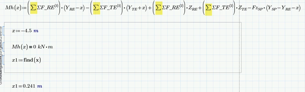

In case you want the values in the matrices you defined with the sum-symbol in their name to really be summed up, you have to tell Prime that it should do so. In this case Mh returns a single value and so a single variable x would be all that is needed:

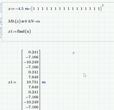

EDIT: A third interpretation of what you are trying to achieve comes to my mind. Maybe you want the definition for Mh to be vectorized?
This would yield
Your function Mh returns a vector of 16 elements.
If you want this vector to be all zeros, this would mean you have 16 single equations.
Because you only provide one single variable x for Prime to vary, Prime is not able to find a solution:
No surprise, as you normally would need at least 16 unknows to get a solution.
If you define your guess as a vector of 16 elements, Prime is able to find a solution.
Not sure if this is what you are looking for:

Hi Werner,
Thanks, that was indeed what I was trying to solve, to find 16 answers in an array.
The vector operator on the formula did the trip for the solve block.
Without the vector operator it already gave a vectorized solution when I left x out, hence wasn't aware of this.
