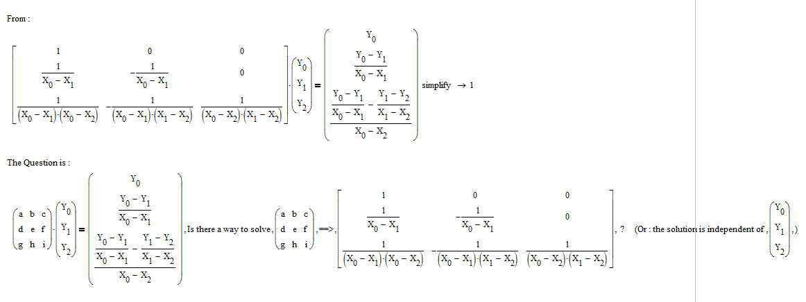

    Hello, Everyone.
   Thanks in advance for your time and help.
        Regards.

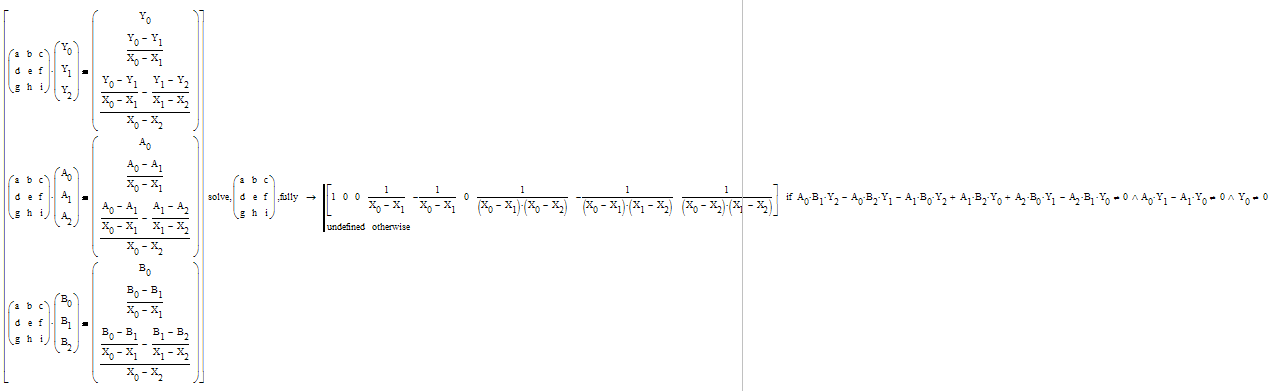

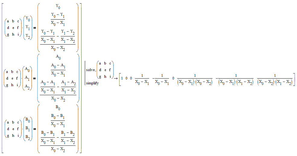

9 variables to solve for, 9 equations;
Werner_E25-Diamond IAnswer
October 25, 2016
