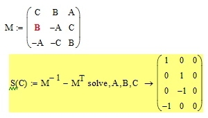

From the following:
The question is: How to find the solution [ A B C ] ?

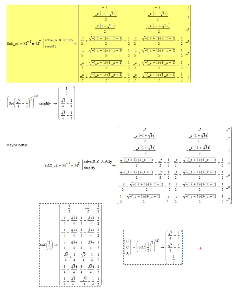

Using Mathcad 11, with:
Then:
And if you select the fourth solution with the proper value of C:
Then A, B and C have the values you specify, as demonstrated by:
And of course, with those A,B, and C:
P.S. In Prime 8:

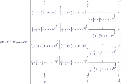

With my MathCad 15 then:
I guess your MC11 engine is better than my MC15 engine in this case, Luc.
Without MC11, I spent a lot of time to find that solution.😅
