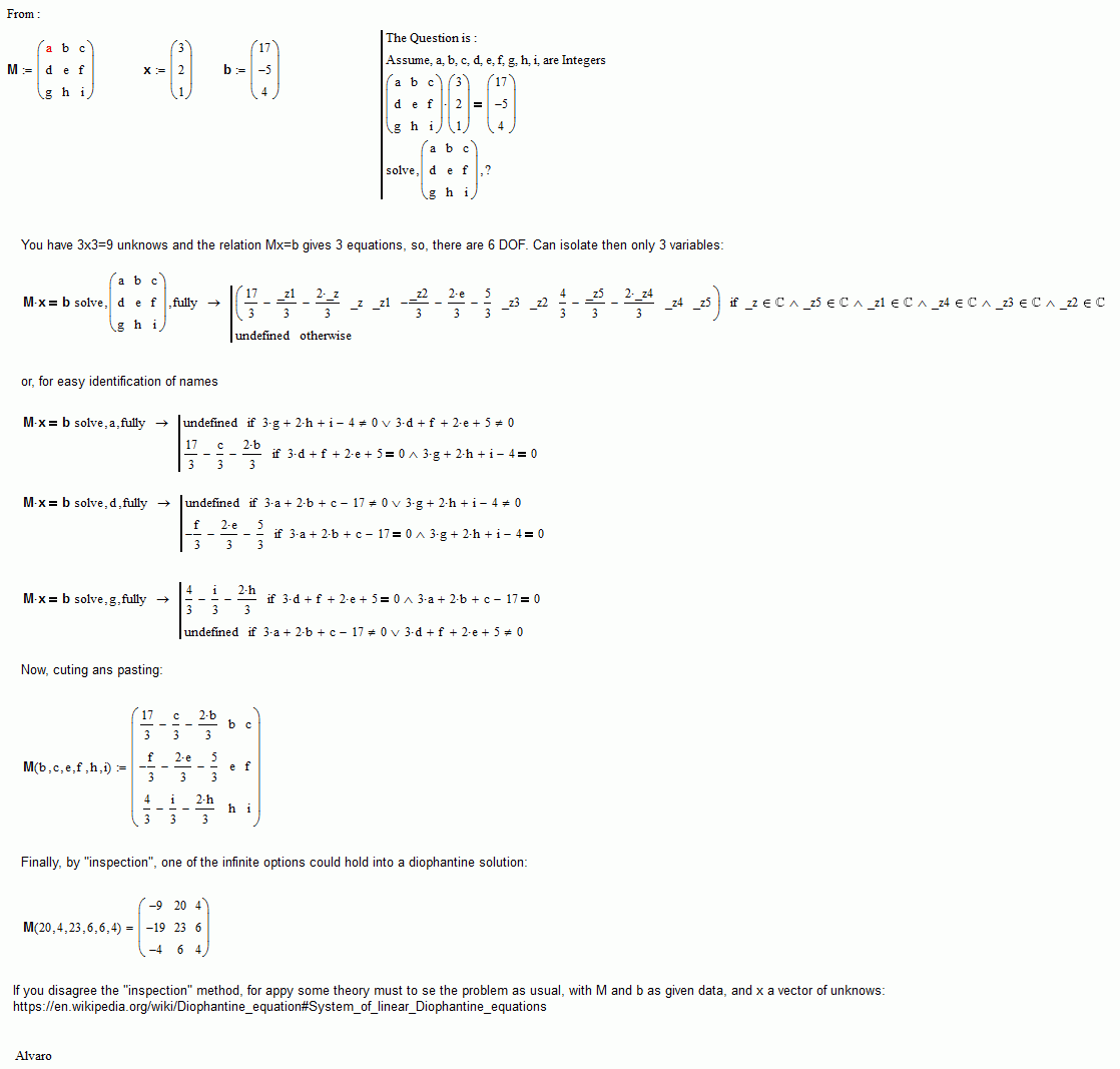

Solve, Matrix with elements are Integers ?
  Hello, Everyone.
  Thanks in advance for your time and help.
      Best Regards.
           Loi.
July 10, 2016
Hi. Just use the "inspection" method. Works. And some background about linear algebra.
Alvaro.

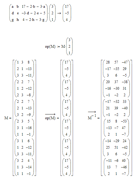

July 10, 2016
Hi. One method for solve this.
Best regards.
Alvaro.

July 10, 2016
Alvaro.
July 10, 2016
Here are a few more soluions:
