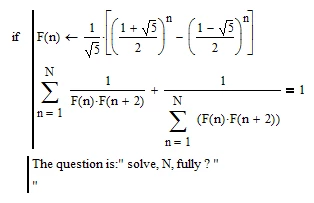

Hi, Everyone.
From the following:
How to solve, N, fully (the above) ?
Thanks in advance for your time and help.
Best Regards.
Loi.

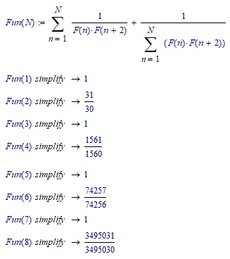

I'd say: Fun(N)=1, solve, N, fully
should give: N is odd.
October 5, 2022
I agree. My assumption N=infinity was grossly incomplete 😉

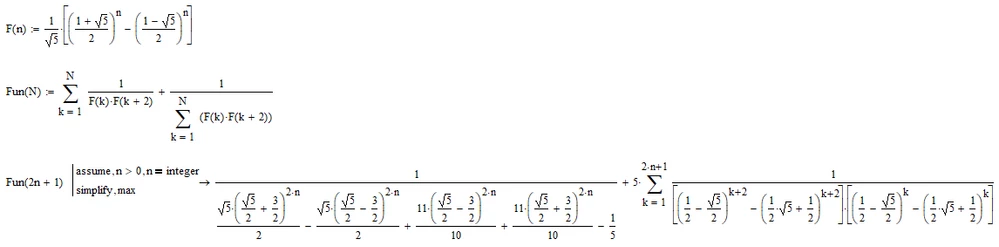

Is Maple in MC11 able to prove it? muPad in MC15 isn't:
Problem is the first summand in Fun(N) (Mathcad changes the order in the result) as already seen here: https://community.ptc.com/t5/Mathcad/Sum-of-reciprocals/m-p/827578/highlight/true#M202986
October 7, 2022
Note that you should not assume n>0, since n=0 gives 2*n+1=1, the first odd number.
Can maple prove it?
Let's try:
That's equivalent to MuPad's result. Setting n to a n integer:
The command simplify:
Doesn't simplify, but simplify, max:
creates a different result, I've never seen simplify, max create a different result from simply simplify in Mathcad 11.
But then again, simplify, simpler  creates that very same result:
