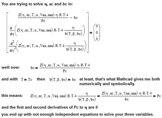

You're trying to solve the system for T=Tc. See what that does to the value of the Covolume Soft-core parameter:
You may get a division by zero.
Further:
I tried to solve the set symbolically (with part of the parameters defined)
and after 30 minutes it found no answer.
Hope this helps.

The system has three unknowns ( εc,η  and bc ) in three equations. As shown in attachment, the Solve Block is solved only up to a certain value of εaa and Vaa ( EOS parameters ).
  The equation you considered added a further variable : b.
