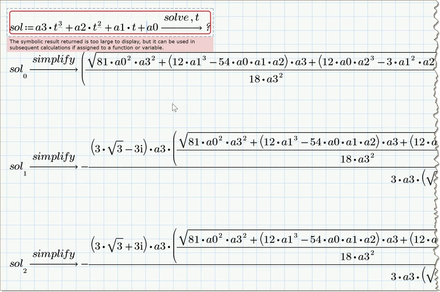

Solve is not working for symbolic. Am I doing something wrong or is there any possible way to get an answer for this ?

Solve IS working. It found an answer, but, as the message says, it's too large to display.
You can assign the result to a function, e.g. by putting
t(C,P,Q1,Z1) :=
in front of it, and evaluate that function with numerical values for C, P, Q1 and Z1.

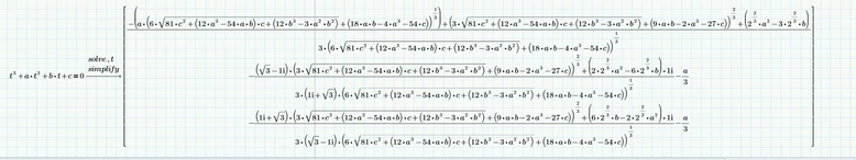

P.S. In case you're interested to know how large 'too large' can be, here is the set of solutions to your problem:
Yes, it's in the picture just above this line...You'll need to zoom in.
Oh, and in case you are wondering: NO, Prime 10 will not show you the result either. It can only be shown by Mathcad 11 (not to be confused with the not yet existing Prime 11).

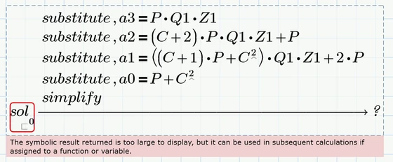

There may be one option though. If you solve this:
does it show? If yes, you can then substitute the four variables a3...a0 with the proper expressions in C, P, Q1 and Z1 for each of the three solutions, and hopefully those results will be not 'too large' to display.

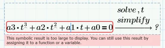

Mathcad Prime 10 is not able to show (so, not solve, but to show) solution results for this third order like equation you want to solve:
Mathcad Prime 10 is able to show solution results only up to second order like equation:

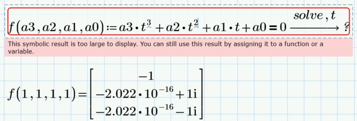

But as Luc said you can assign a function and then put numbers into this function for each variables:

factor a3 isn't needed, if the equation is simplified, Prime can (just) handle it:
Note, without the "simplify" key word,  the result is still too large to display...
