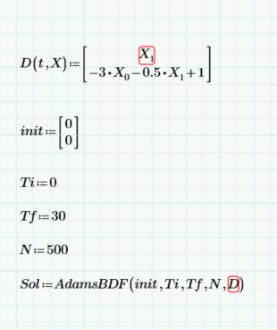

I' new in Mathcad Prime. i need it to solve ODE systems.
I try to solve the Example of the GDG solver with the AdamsBDF methode.
My problem is the vector function. I don't find any solution. Same thing with rkfixed. I hope anyone can help me.
I can't open your file but it looks to me that you used literal indices (with ctrl+-) instead of vector/matrix indices (with [).

Yes, he did.
fgörlich1-VisitorAuthor

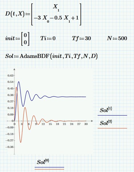

Hey,
yes that was the problem. Thanks for helping.
