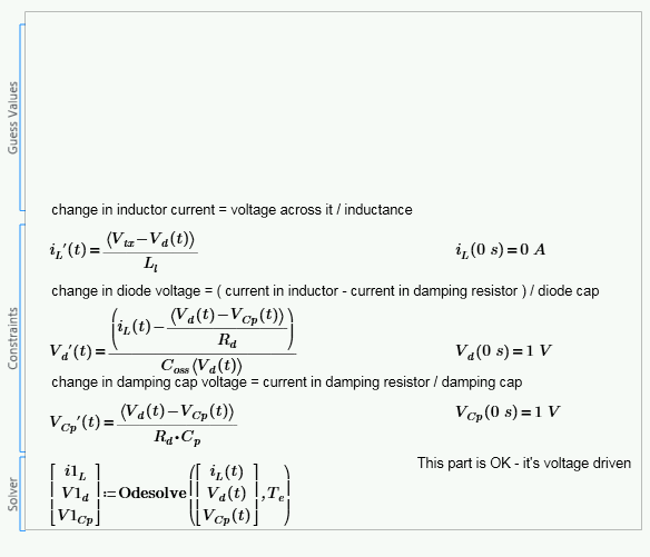

Yes, just use the : as normal to assign the value / result.
Example is for an Ode, but the same will apply for any solve block.
Mathcad 15:
Prime (2):
Because Prime handles the units a little better I was experimenting with this program to learn about prime - still not convinced...
Hope this helps
Andy
