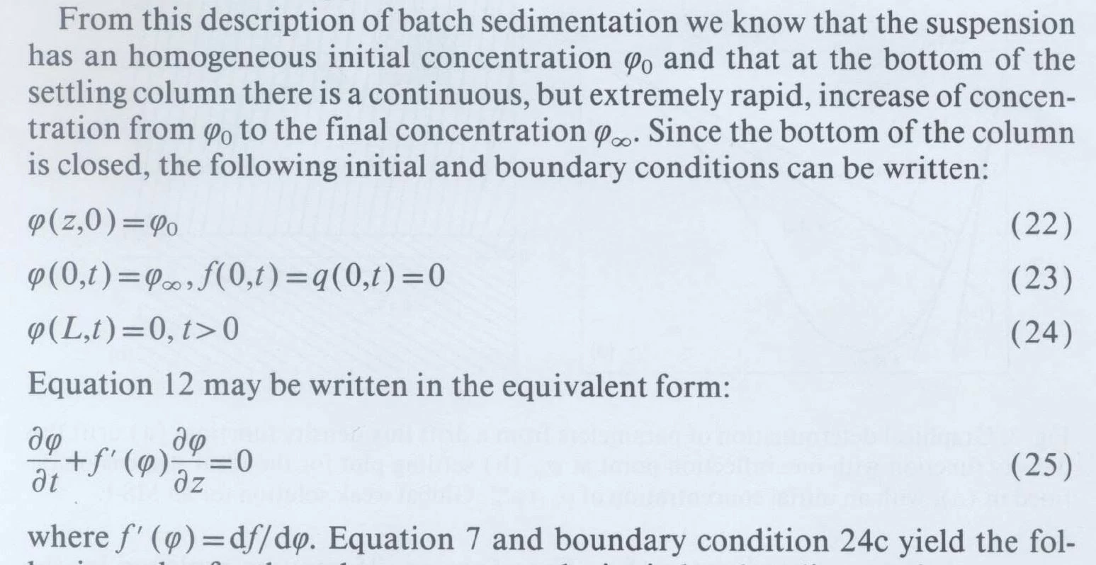

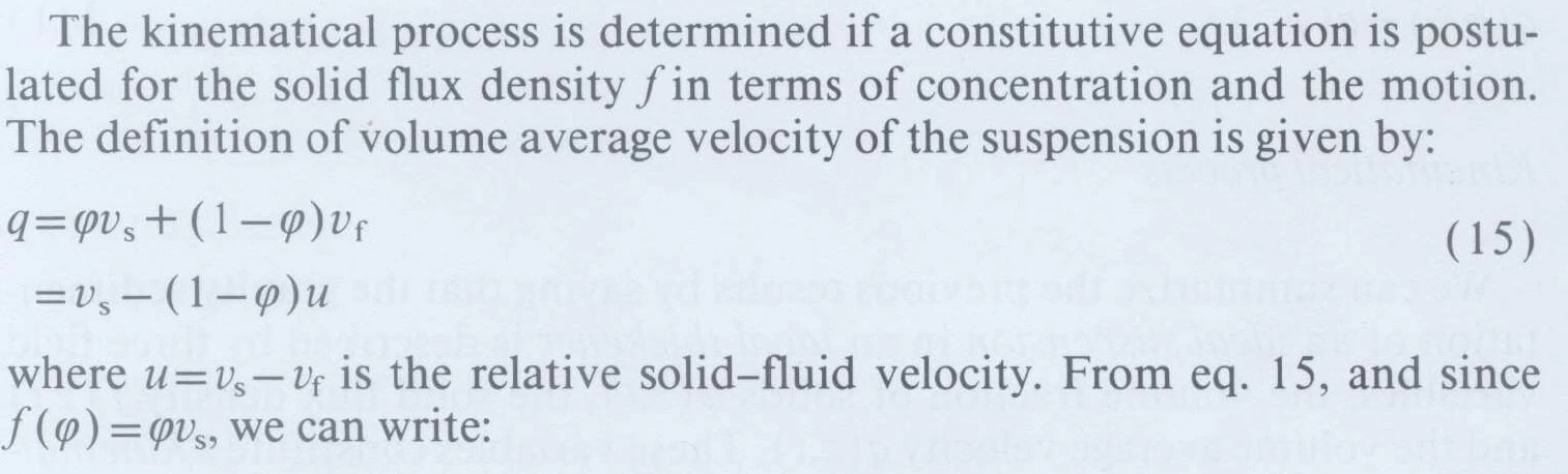

         I am trying to solve the Kynch sedimentation process. For that, I need some help solving PDE with certain initial and boundary conditions. The objective is to get volume fraction (ϕ) in terms of height (z) and time (t). I am not really sure on how to go about doing this. It would be helpful if someone could take a look at it.

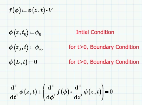

You appear to be using phi as a variable and as a function at the same time.
That is begging for trouble. You have to clear this up before you can begin to solve.

       I have followed the equations given in the paper. Kindly check the attachments.
February 7, 2019
To my opinion the paper uses inconsistent formulation.
At one time f is a function of just phi: "f(phi)".
At another point it is a function of two variables: "f(0,t)".
Mathcad, nor Prime will be able to work with that.
P.S
In your usage of Prime, with the derivative, you can leave the 'order' of the derivative blank if it's just 1 (It's only needed for second and higher order derivatives). That 'll help with readability.

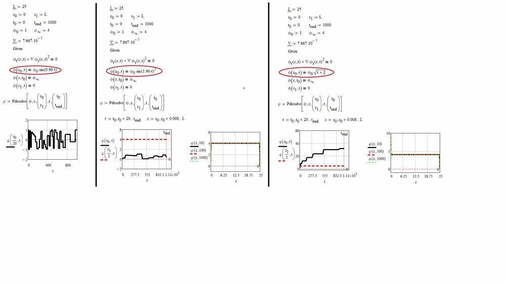

February 10, 2019
Below are my attempts to find a particular solution, using MAthcad 15, to the equation, after having defined the boundary condition for ϕ:
