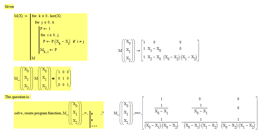

solve, program function ?
  Hello Everyone.
From :
And the question is : solve, create program function M_(  ) , the above ?
    Thanks in advance for your time and help.
         Best Regards.

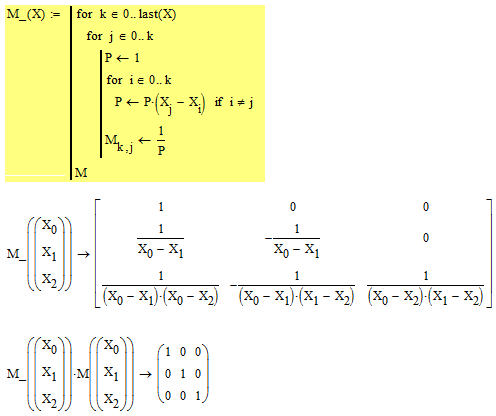

December 28, 2016
OK.  How about this?
December 28, 2016
Must it be a program?  The following function would work:

MJG1-VisitorAnswer
December 28, 2016
OK.  How about this?
