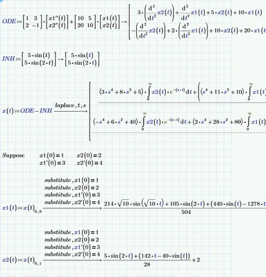

Please guide me to solve System of Differential Equation in Mathcad as Example below
Mx''+Kx=p(t) harmonic force
If this example is error please feel free to change the purpose is how to solve in Mathcad Prime
Thank u

You have to provide initial conditions for x1 and x2 and their first derivatives.

Thank u Luc
