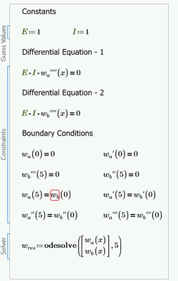

Hi I am trying to solve system of 2 ODE as shown below. I am unable to find out the issue.
The error happens when I m trying to relate the first ode to the second one. I am getting error as "Unknown error: ode% _function% _illegal % _context. Please help!

Please attach your Prime worksheet.
Suki10-MarbleAuthor
September 15, 2022
Hi Luc,
The calculation has been done at the bottom of the mathcad sheet. Please see attached.
Sukrit
September 15, 2022
Have a look here https://community.ptc.com/t5/Mathcad/Multiple-ODE-s-in-MathCad/m-p/785905#M200434
Similar problem, solved.
23-Emerald I
September 16, 2022
I can't use solve blocks (I only have Express), but by integrating and applying boundary conditions to evaluate integration constants we can still address this problem.  I doubt that you intended to set such a simple problem.  Attached is Prime 4 discussion.
